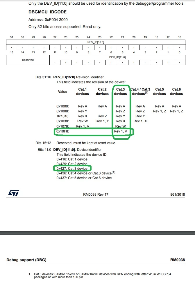

STM32L151RDT6 (SMD marked as rev V) but ST-Link utility displays "Unknown" revision ID and wrong flash size(256 isntead of 384KB) (ID_CODE = 0x10f86427) . Where I can find full list of silicon revisions of this particular MCU ?

In addition to that. Debug session allways start with the HardFault_Handler().
What I have noticed that for the particular MCU there is A, Z, Y, X, 1 revision (according to errata sheet) and no one has 10f8 ID CODE.
Looks like i got a clone.

The Reference Manual and the Errata?
The RM should have details of the Chip, Stepping/Revision, and also the address in OTP to read the tested flash size from.
https://www.st.com/resource/en/reference_manual/rm0038-stm32l100xx-stm32l151xx-stm32l152xx-and-stm32l162xx-advanced-armbased-32bit-mcus-stmicroelectronics.pdf
https://www.st.com/resource/en/errata_sheet/es0240-stm32l15xxc-stm32l15xxd-stm32l15xxca-stm32l162xc-stm32l162xd-device-errata-stmicroelectronics.pdf
STM32L15xxC STM32L162xC Rev 0x10F8

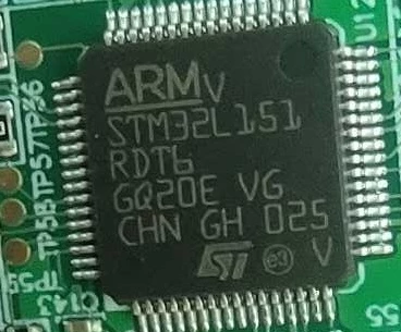

Should be marked as "1" or "V", please attach a large, clear, in focus image of the part in question.
OrestHWeng
July 11, 2022
OrestHWeng
July 11, 2022

And the screenshot of document is page of ERRATA to L15xx family of devices

Looks to be a die out of Crolles, so not a clone. Could well be something that was waived out to a specific custom, and thus not a retail part. Assuming you picked these up from the secondary market.
For Cat 3 devices the FLASH size is reported in a 16-bit word at 0x1FF800CC
If you touch beyond the usable memory on-die it will Hard Fault, suggest having the Hard Fault routine unpack the observed state/registers.

According to document from Product page on Mouser (Where actually I bought those MCUs) https://www.mouser.com/PCN/STMicroelectronics_10548.pdf
Change is visible through assembly traceability plant, in the marking:
- “GQ�? and "GH" for Stats ChipPAC China
and it is not from Crolles!

I said the die is out of Crolles, looks to be packaged/assembled in China.
Work with your FAE out of Mouser, and have them work their ST contacts. If it's from Mouser they should be able to establish provenance and traceability.

Enough boxes are checked here that it's likely a legitimate part, and whatever production side has done seems to have repercussions that the documentation and tools side hasn't fully caught up with, at least publicly. The documentation likely exists, and I'm trying to shake the part of the tree I have hold of to get some answers/attention.
ST has a history with odd orphan / step-child parts, where delivery has been made using equivalent, or better, die to meet demand of specific parts and foot-prints.
