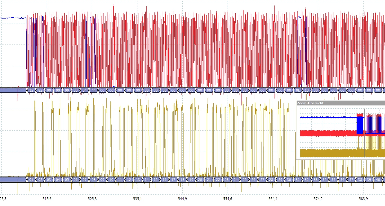

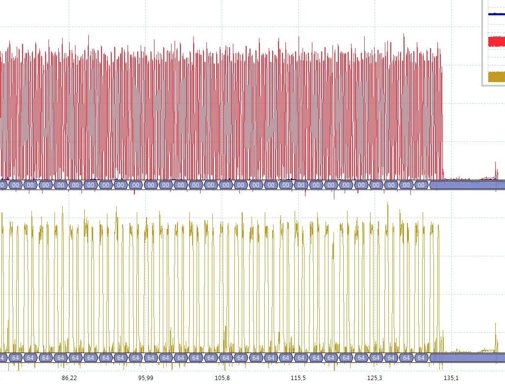

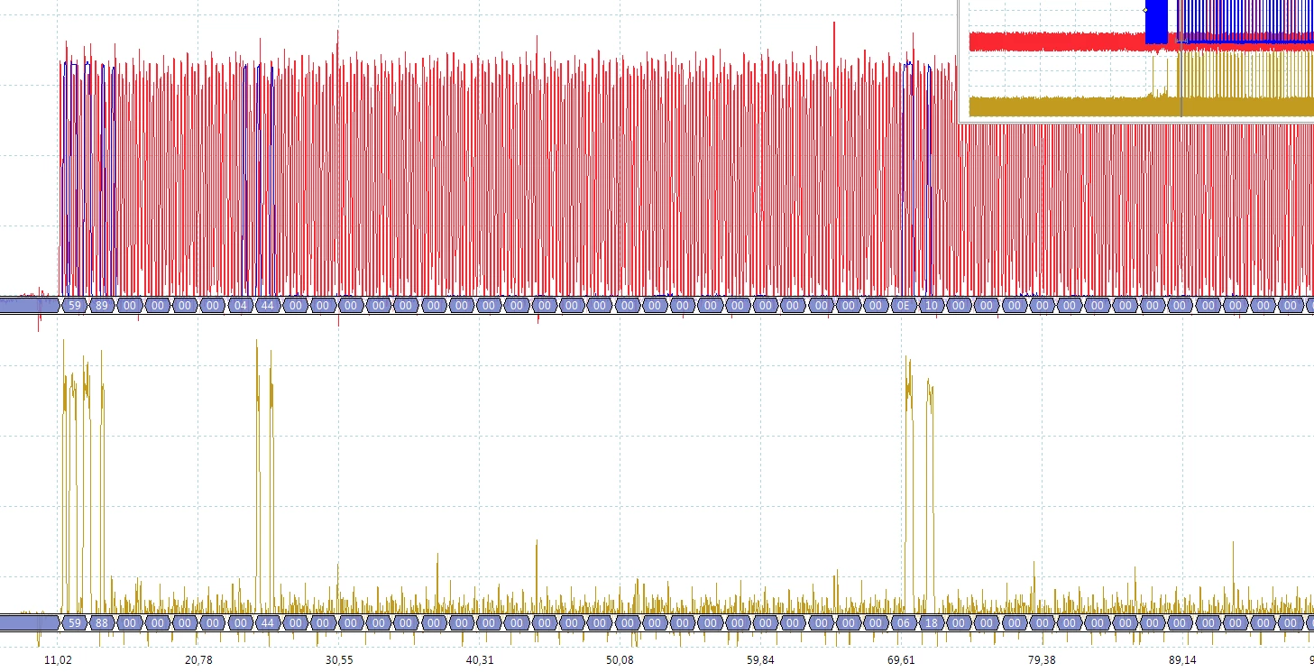

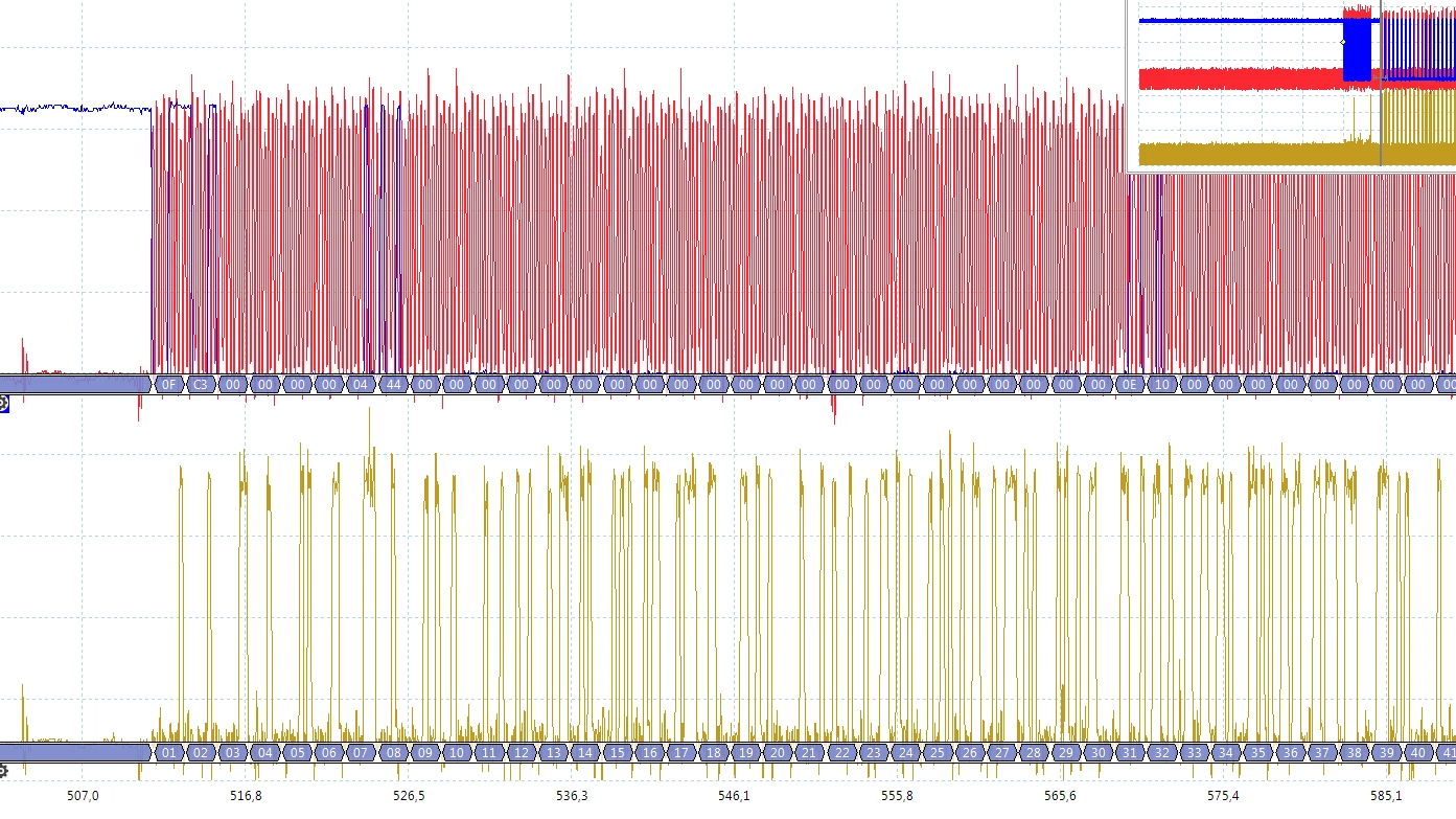

Chrizzly
ChrizzlyAuthor
November 18, 2021
Thank you guys for your answers.

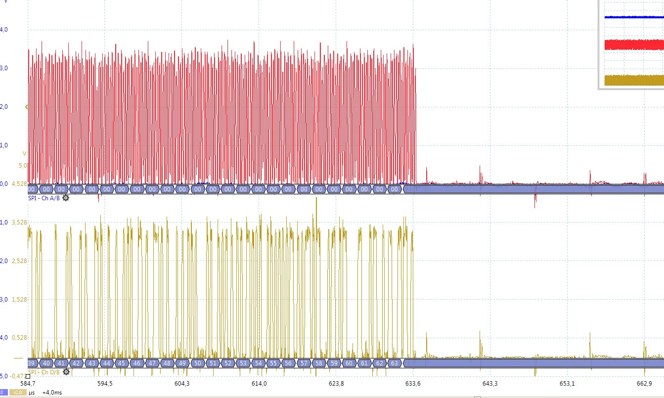

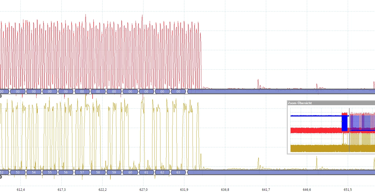

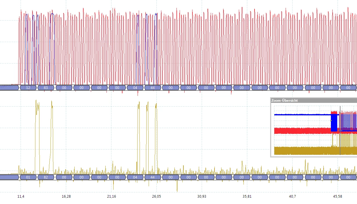

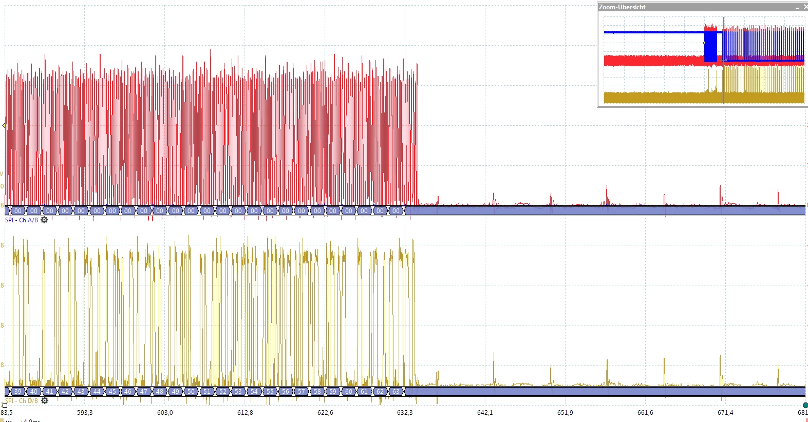

I think I understand the basics of DMA and what it is used for. I think I am struggeling to understand how to use it properly so there is no conflict of accessing Data.
Unfortunatly the HAL_SPI_TransmitReceive function is to slow (see the description of my problem).
With the code below and two problems occured:

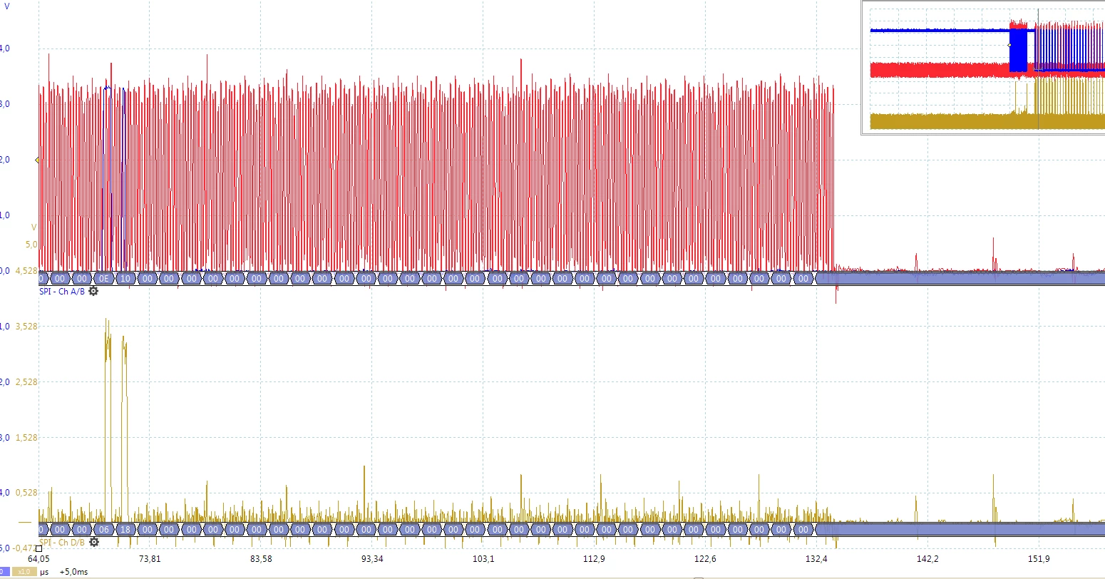

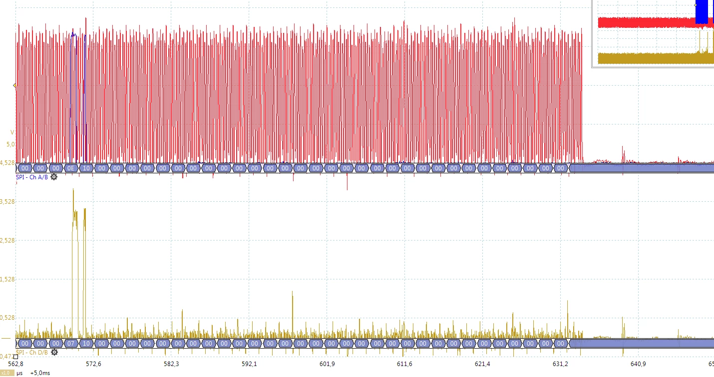

  • Data is not received properly / corrupted by my software (See attached Files Package_1 to Package_3)
  • After the 1st Package the transmission gets stuck at 64 (See attached Files 64_Problem)
Either one of the scenarios happen whenever I trigger the communication.

Thank you so much for your answers and your patience MM and JW. I really appreciate your help.
I set up SPI DMA as circular in CubeMX. SPI1_RX DMA1 Channel 2 Priority High and SPI1_TX DMA1 Channel 3 Priority Medium.
How can I get a feedback wether my code is to slow or not? Is it realistic that my code is to slow when my CPU runs at 32MHz?
The problem that data is not received properly / corrupted by my software (See attached Files Package_1 to Package_3) still exists.

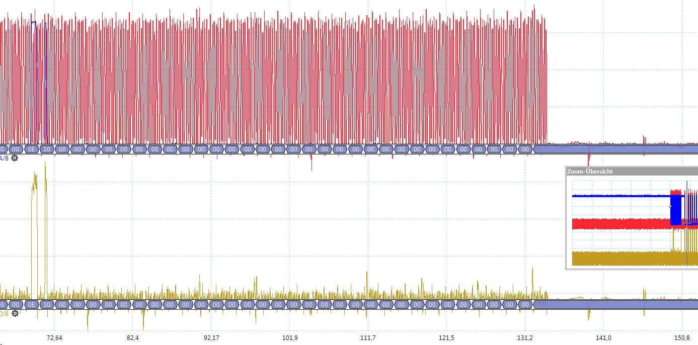

Chrizzly
ChrizzlyAuthor
November 18, 2021
Thank your for your answer!
I followed your advice.
I changed SPI DMA back to normal mode.
I set the breakpoint in the if condition.
Result:
The programm did not enter the if condition.
After the transmission of the initial package with the numbered bytes array (Configuration_Values_Tx[64] = {1, 2, ..., 64 }) was sent the following 64Byte packages had a value of "64" for each byte (like the "64_Problem_Package_2_01" screenshot).

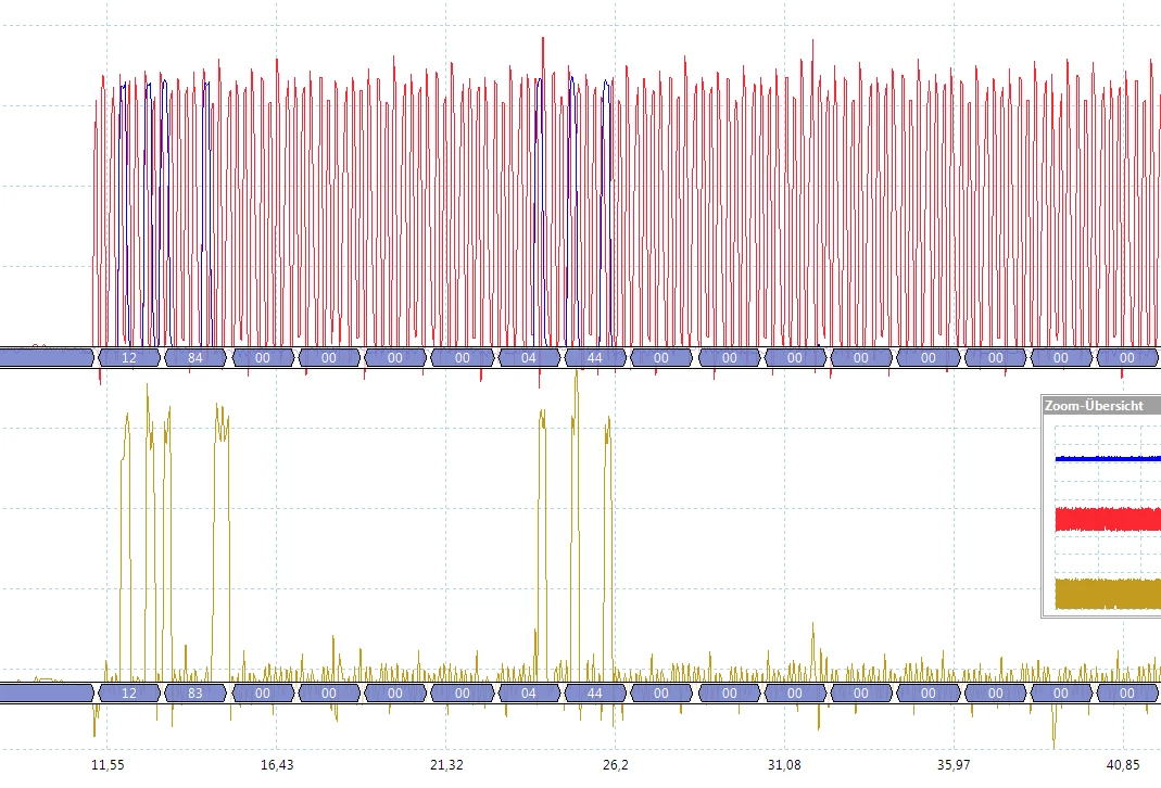

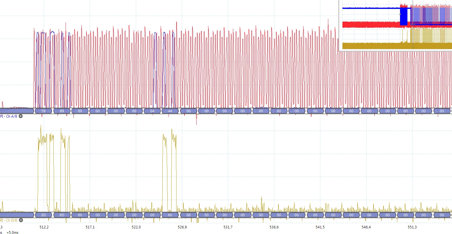

Maybe your trouble is not synced start. When you call
HAL_SPI_TransmitReceive_DMA(&hspi1, Configuration_Values_Tx, Configuration_Values_Rsx, 64);
your link on SPI need be without trafic. But when Master sends your data will bad and not sync...
You need add some waiting for pause.
Better is when Slave send requst IRQ to master and this start send based on it.
And from your images isnt clean Data is valid on rising or failing clock edge ? Is SPI set to this?
And when you go back to normal DMA you need restart it in code for too fast check. I dont see in your code restart. ...

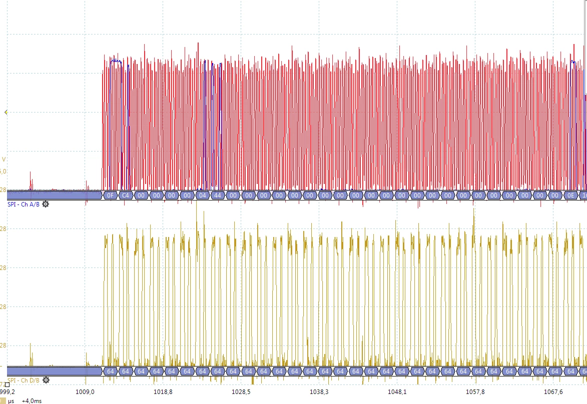

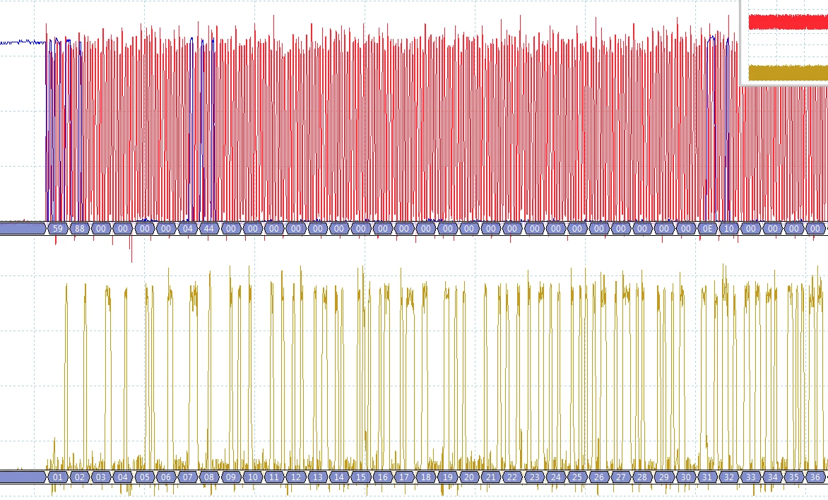

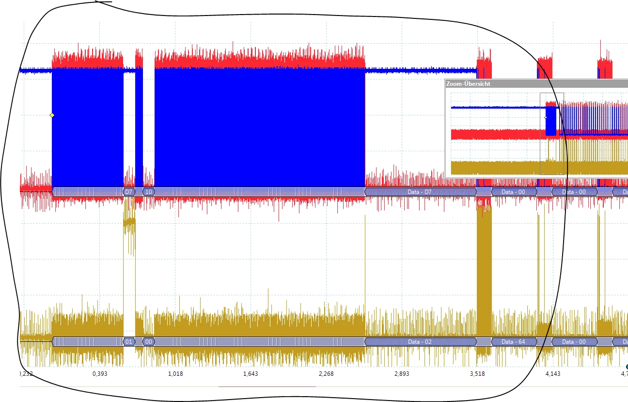

Chrizzly
ChrizzlyAuthor
November 19, 2021
Thank you MM for your advice!
I didn't realize my clock phase was wrong. I changed it to second edge.
I configured DMA to circular.
After the configuration process the slave responds with a 0x02 indicating that it is ready.
  1. The 1st Package is my initial dummy 64 Byte Array
  2. The 2nd Package should be the received data from the 1st transmission, but the 1st byte of the seconde package is always 01.
  3. The 3rd Package and the following Packages are correct.
The 01 could be from the 1st package where the dummy values are sent, but why? The 3rd and following packages don't show this behavior?
