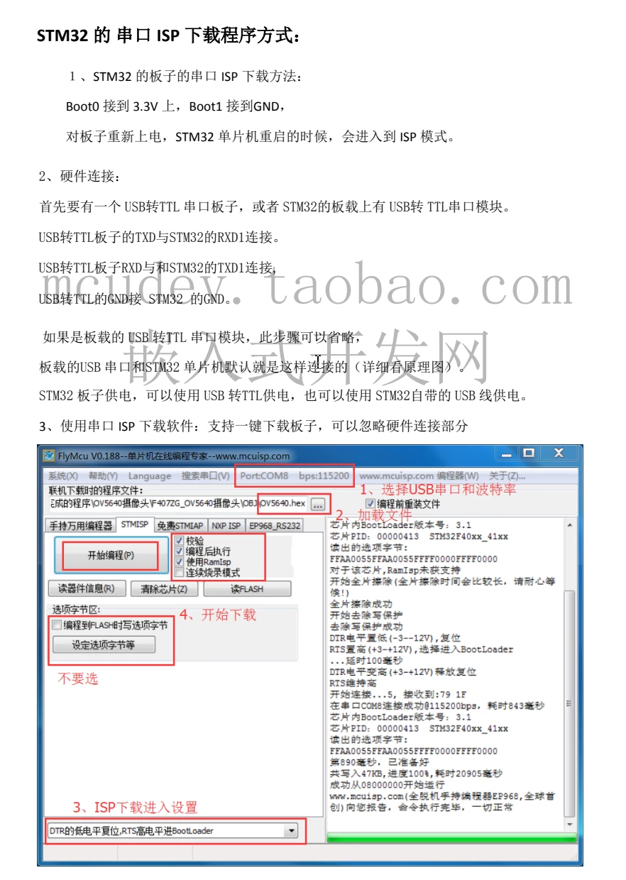

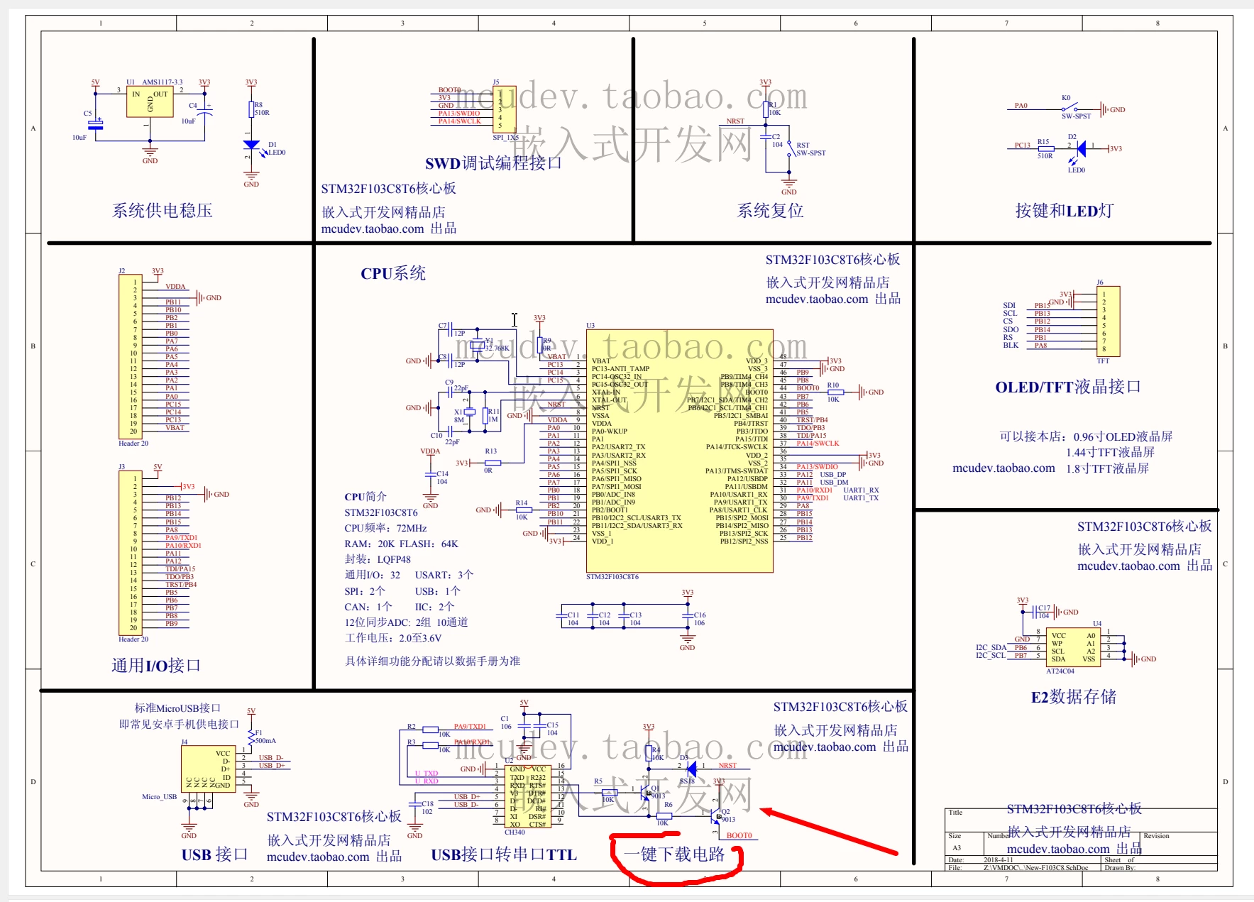

Can STM32L151C8T6/STM32L151CBT6 download ISP with one click?
Can you provide a reference circuit diagram?

xwang.6
xwang.6Author
February 13, 2023
0693W00000YAYc8QAH.png0693W00000YAYqMQAX.png Please refer to Figures 1 and 2,Use software FlyMcu to download the program to PCB via USB to serial port( STM32 USART1)
