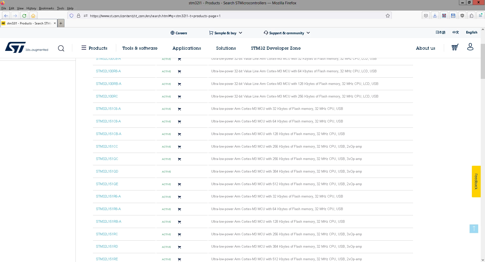

waclawek.jan
May 11, 2024 8:17 AM UTC
News.
As spotted by Philipp Klaus Krause, one of the principial developers of SDCC, STM8 were un-NRND'd.

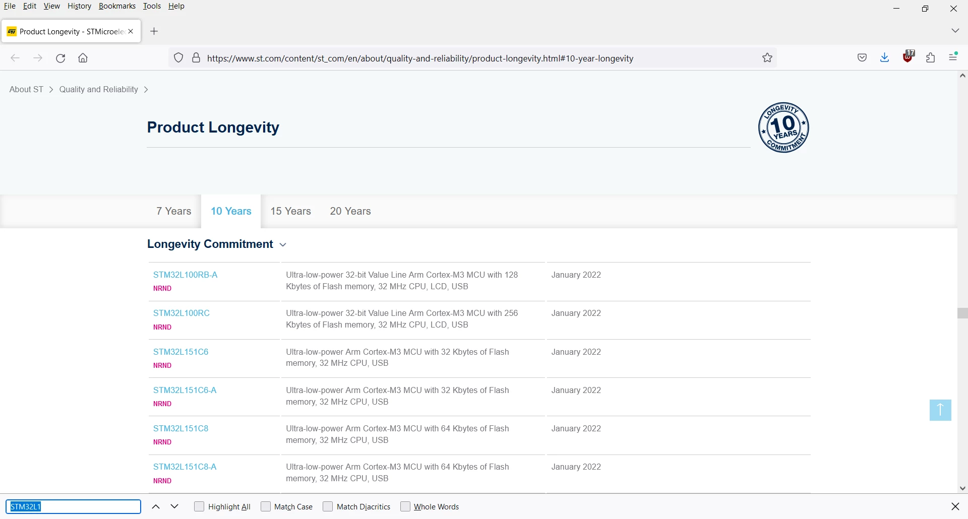

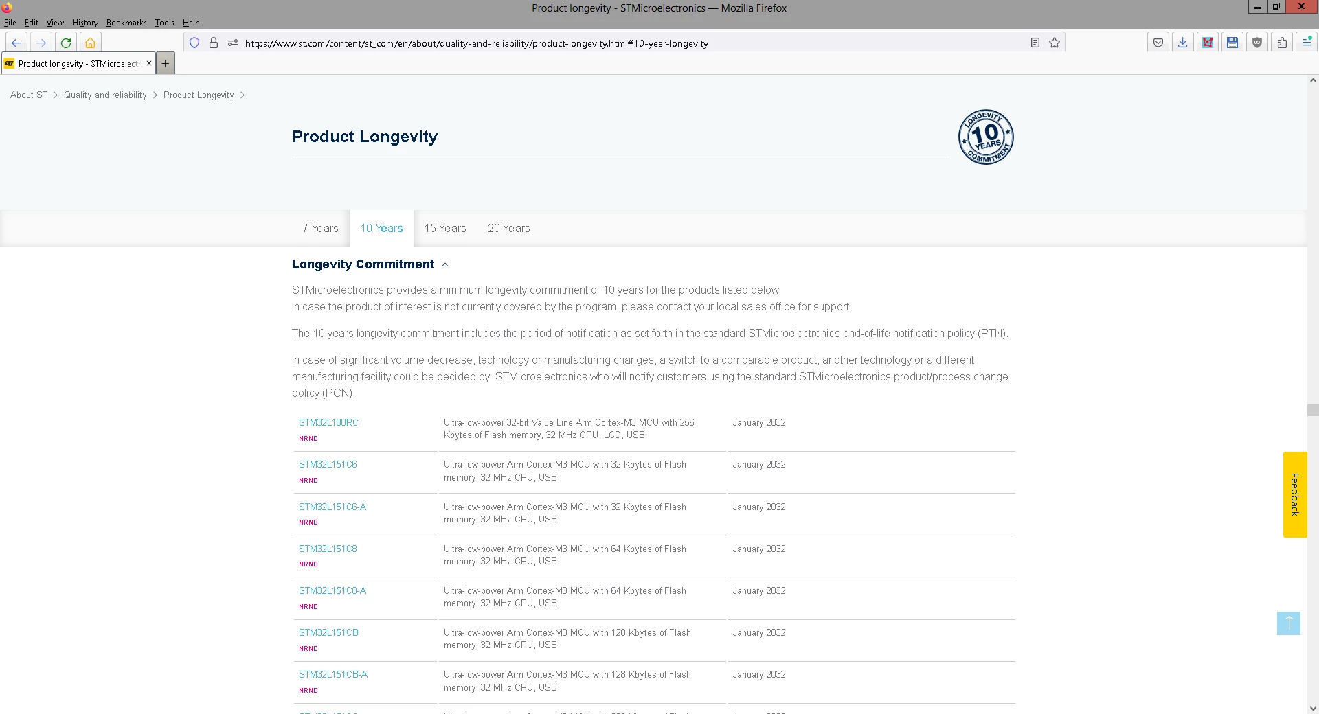

So, I looked at the 'L1, too - the newer ones from them (as witnessed by the -A suffix on some of them) appear to be un-NRND'd too:

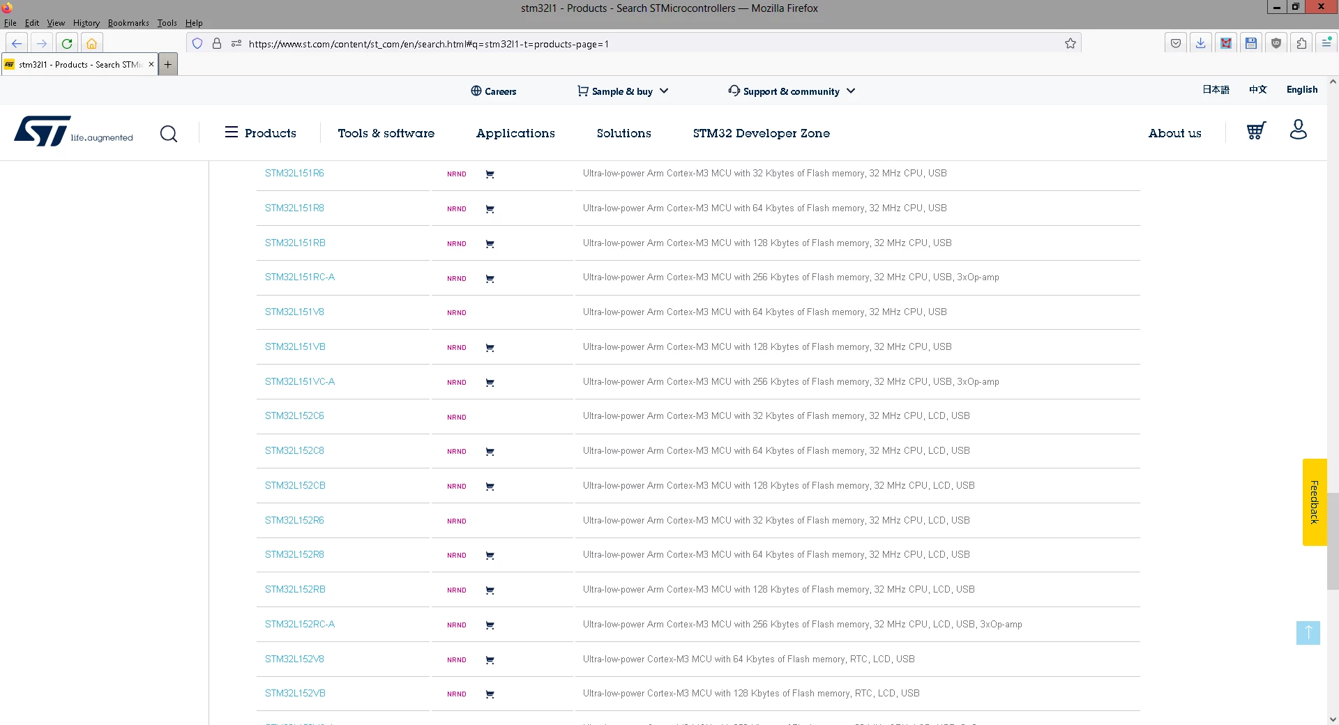

and although only the older ones appear to be still NRND'd according to the product list:

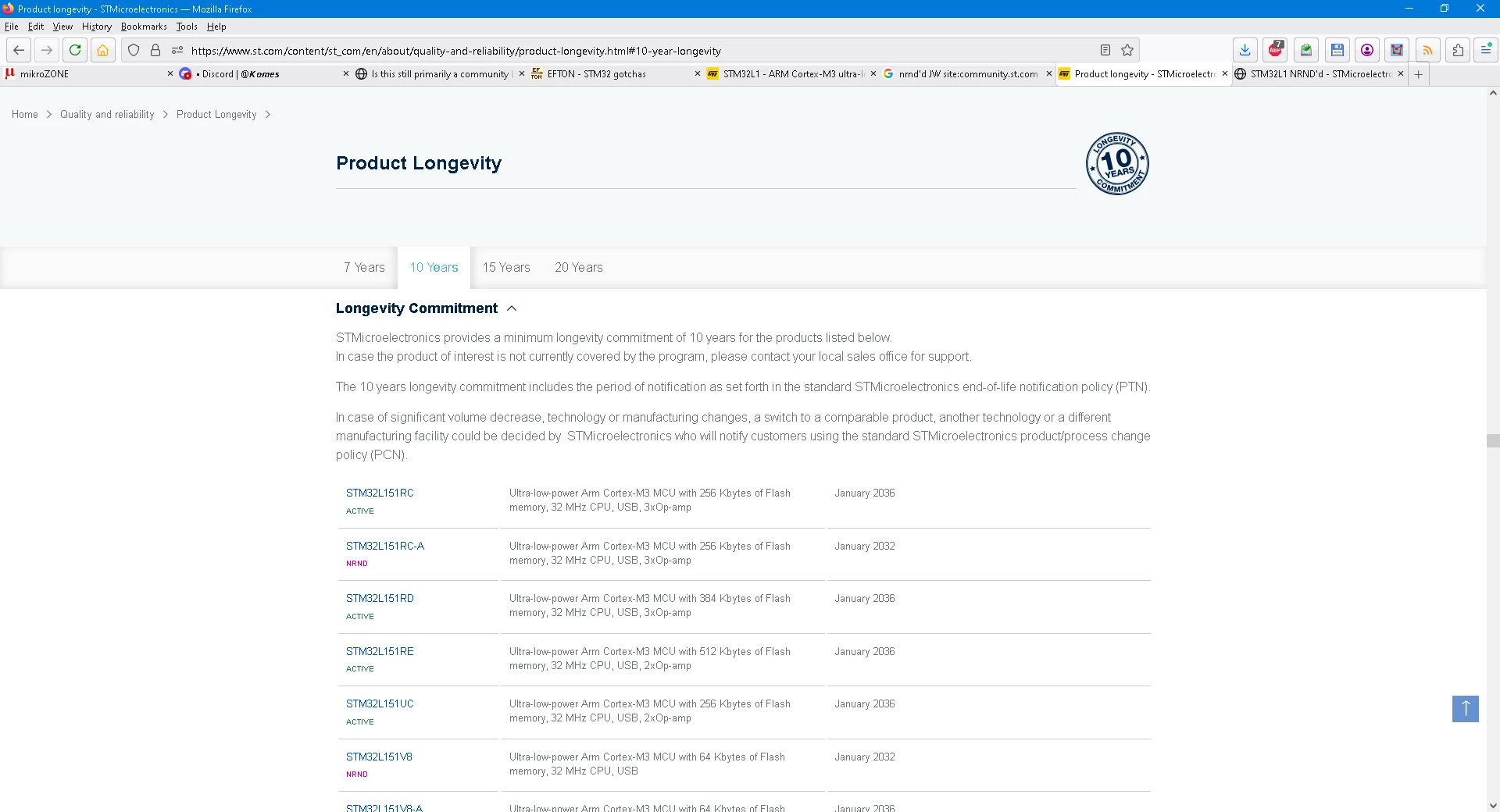

the 10-year commitment list lists all of 'L1 as NRND with the end-date not renewed and to be expired at Jan 2032:

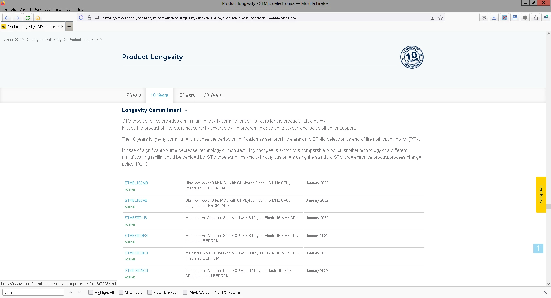

Btw. the STM8 (except automotive) are in the 10-year commitment list listed as Active but with non-renewed expiration at Jan 2032 too:
