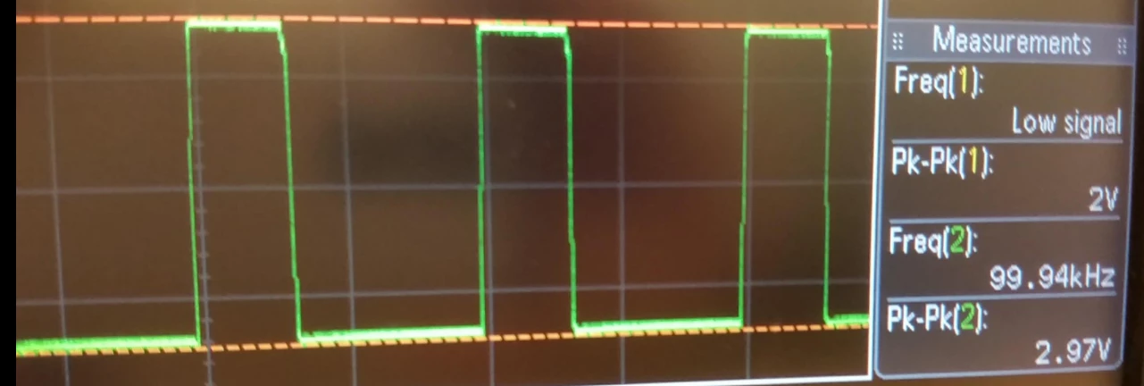

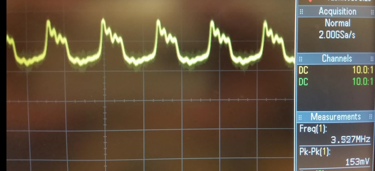

When I run my board with this code I find that the TIM4 correctly ouputs a 100KHz square wave with a peak to peak voltage of 3V. The TIM11 channel outputs an unclean square wave with a very low peak to peak voltage and only approx. a 3.5MHz signal. If I try to reduce the prescaler value to 1 in order to increase the frequency further, I lose the waveform completely. The results from the oscilliscope are show below:
TIM4 -
TIM11 -
Any help on getting the TIM11 pwm to be a clean square at 5MHz with 3V peak to peak would be greatly appreciated.

waclawek.janBest answer
Mar 6, 2018 10:36 PM UTC
Posted on March 06, 2018 at 23:36
Set higher speed setting on given pin in GPIO.
How do you load that pin?
Also, check your oscilloscope probe rating.
If you need pwm if that kind of frequency, there is something serious wrong with your approach, usually.
Probably yes, but the waveform should be clean nonetheless.

Mar 7, 2018 12:03 AM UTC
Posted on March 07, 2018 at 01:03
5MHz PWM should be easy enough. but maybe not exactly 5.0MHz
Its child's play for the STM32 processors.
there will be no CPU overhead
Waclawek.Jan
‌ is correct,
check the PIN IO Speed.
check the ground probe on your scope.
check the pin loading.
Upto about 16MHz should be possible, however, since the process is ' divide the fixed frequency primary clock', only some frequency choices are available. 32Mhz/2, 32/3. 32/4 etc.

Arthur Franca
Mar 7, 2018 4:54 PM UTC
Posted on March 07, 2018 at 17:54
I have now corrected the speed setting on the pin by putting it to a high setting.
I then kept my period value at 2 with a pulse of 1 for a 50% duty cycle. My prescaler value I tried placing at 1. This would in theory give me my approx. desired frequency according to this equation I found online:
   Desired Freq = MCU Freq. / ([Prescaler +1][Period+1])
   5.3333MHz = 32MHz / ([1+1][2+1])
Upon testing this I found that I still had a similar issue:
- With prescaler set to 1 there is no output at all
- As I increase the prescaler value I get an output at a low amplitude with the expected frequency until approx. a prescaler value of 9 where I get a full 3V peak to peak clean square wave
I have checked my oscilloscope rating and it samples up 100MHz so there should be no problem there.

Arthur Franca
Mar 7, 2018 6:25 PM UTC
Posted on March 07, 2018 at 18:25
Hi Ted,
Sorry the high setting did work! It was a weird coding issue I've now fixed.
The denominator in the formula is [1+1][2+1] = 2*3 = 6
I now am getting the 5.3MHz wave. however I am also getting a significant amount of noise on both timer channels now:
https://scontent-sea1-1.xx.fbcdn.net/v/t0-12/28722352_10216521141648890_1114448581_n.jpg?oh=f8ad7d451adf8ae0b98773e573e427a9&oe=5AA1F719
Zooming in closer:
https://scontent-sea1-1.xx.fbcdn.net/v/t0-12/28741184_10216521141688891_1889000873_n.jpg?oh=95db2874d583d607edd04974cadcf1a1&oe=5AA2F13E
