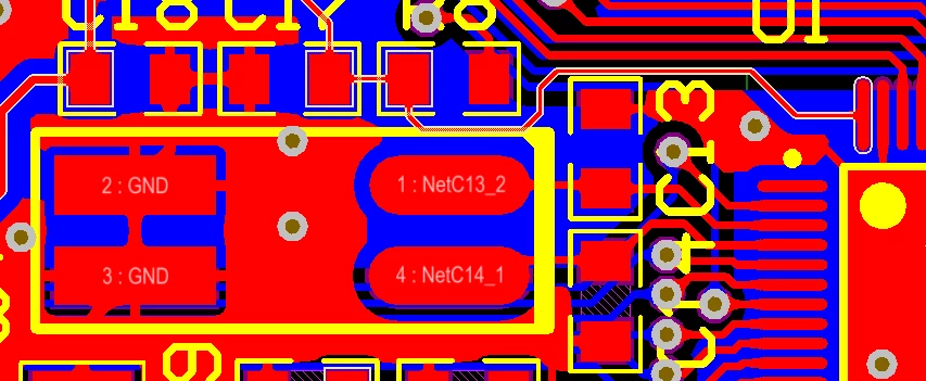

    Here is the Layout:
    The bottom polygon is connected to GND too.
    C13 and C14 are crystal Caps, first i used 12pF caps, no result.
    I changed it to 10pF and now it works !
    Crystal is:
    Epson  MC-406 32.768K-A3
    Crystals 32.768KHz 12.5pF -40C +85C
    I worry for later working ... after i checked forum, i saw many others have same problem, the oscillator is too sensitive, i can't trust on it for long time working !
    Is there anyway to get sure the OSC works fine later too ?!!

    Can I use LCR meter to find the PCB capacitance ? or total capacitance when crystal is connected to MCU (after soldering...) ?
