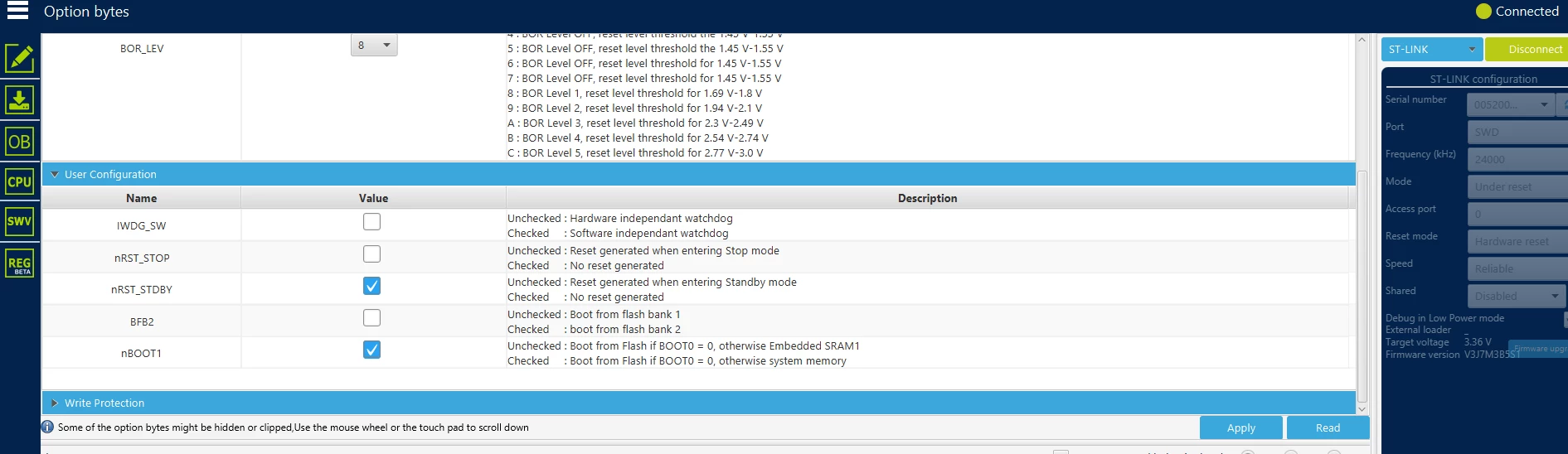

March 17, 2022
Show a screenshot showing the IWDG is disabled in option bytes in STM32CubeProgrammer.

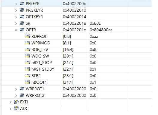

JJRRAuthorBest answer
March 21, 2022
So now It is clear. I had unchecked WDG_SW - it means the IWDG was activated by harware and this is why the reset occured.
What I do not understand is why this bit was unchecked.
March 21, 2022
If IWDG_SW is unchecked, IWDG is enabled automatically by hardware and is causing your reset, as suspected in the very first reply to your post.
