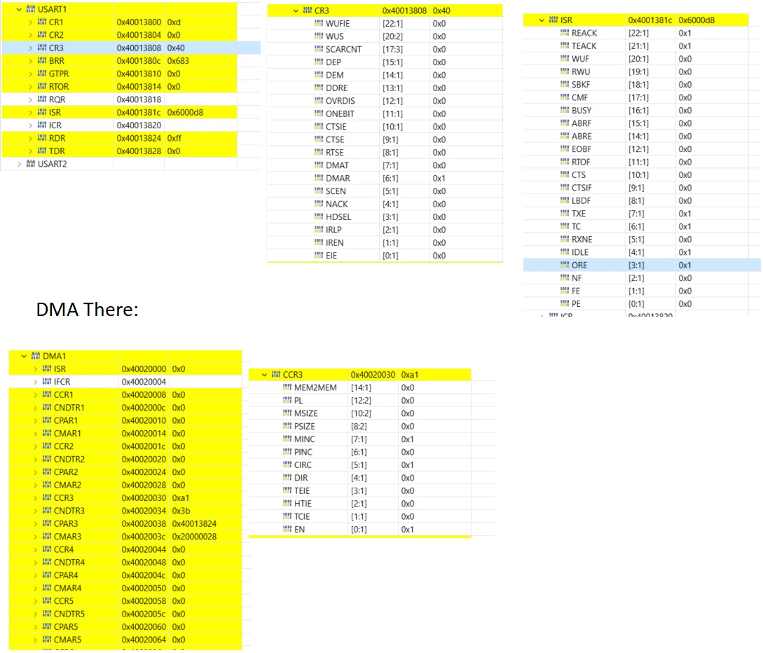

Hi, Thank you, UART_CIRCLE_MAX_BUFFER_SIZE > 1 (for now I tried = 60). Registers bellow:

Clear the overrun issue.
Identify why you aren't monitoring receiver continuously (probably when it's not in the blocking function), and implement identification and clearing of errors like Overrun, Noise, Parity, Framing which will block reception until explicitly cleared.

If ORE is set, does it means the DMA does not read the RDR and pass t to the GlUartRxBuffer?
I want the DMA to read every received byte on UART1 and store it in GlUartRxBuffer - and do this in circular mode, without any interrupts.

Suggests at some point you weren't servicing it.
Large circular / continuous DMA shouldn't miss data, but might get other errors that need to be cleared, say the lines glitched, or baud rates changed, cables connected, etc. DMA perhaps best serviced in HT/TC interrupts, or data periodically harvested.
If ORE is set, the DMA doesn't know that and keeps running. It's the UART stops receiving - you need to detect and clear ORE to let it go. Newer STM32s have option to disable ORE so it never occurs at all (TL;DR but this has other complications).
