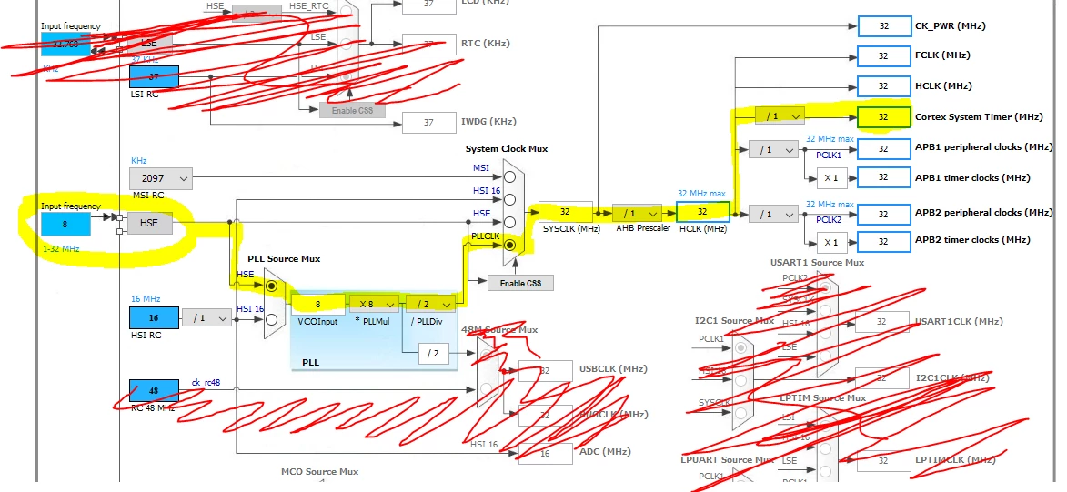

Hello all. I am new to STM paradigm. I have a Nucleo 64 STM32L073RZT6 64 PINS board.
I was trying to configure the Systick timer, however it seems that the input Systick frequency is always divided by 2.
I am using the on-board 8MHz external crystal (which is originally used by the ST-Link interface) but the board marking that I have is MB1136 C-04. According to the hardware pdf, it means that the HSE input of the microcontroller is actually the 8MHz crystal of ST-Link.
Here is my PLL configuration (please read the comment maybe I missed something obvious):
RCC->CR |= (1 << 16); //HSE on 8mhz
RCC->CFGR |= (1 << 22); //PLL out div by 2
RCC->CFGR |= (1 << 0) | (1 << 1); //Select Sysclck as PLL
RCC->CFGR &= (~(1 << 7)); //clear bit 7 for AHB prescaler = 1
RCC->CFGR &= (~(1 << 10)); //clear bit 10 for APB1 prescaler = 1
RCC->CFGR &= (~(1 << 13)); //clear bit 13 for APB2 prescaler = 1
RCC->CFGR |= (1 << 16); //PLL source is HSE
RCC->CFGR |= (1 << 18) | (1 << 19); //PLL multuplier = 8 (i.e 8mhz hse * 8 = 64 div by 2 = 32 Sysclck maximum)
RCC->CR |= (1 << 24); //PLL on
while((RCC->CR & (1 << 25)) == 0); //wait for PLL ready
SystemCoreClockUpdate(); //SystemCoreClock variable is 32Mhz (confirmed by debugger)
And then here is my Systick configuration:
SysTick->CTRL = 0;
SysTick->LOAD = 31999; //Systick clock/1000 - 1 for 1ms systicks interrupt
NVIC_SetPriority(SysTick_IRQn, (1<<__NVIC_PRIO_BITS) -1);
SysTick->VAL = 0;
SysTick->CTRL |= SysTick_CTRL_CLKSOURCE_Msk; //choose full AHB as source clock (no div by 8)
SysTick->CTRL |= SysTick_CTRL_TICKINT_Msk;  //enable interrupt
SysTick->CTRL |= SysTick_CTRL_ENABLE_Msk; //Enable systick
I am getting a 2ms interrupt instead of 1ms. I checked the PLL clock divider in RCC-CFGR and it was indeed 0 (i.e. no division). There has to be a division by 2 somewhere that I am missing. My reference is the STM32CubeMX Clock Configuration and of course the datasheet.
I don't really know where else the problem could be. Any help would be appreciated!

Well the usual configuration is that the ST-LINK outputs 8 MHz via it's MCO pin and that feeds the HSE-IN of target. BYPASS is supposed to be used in these cases, so it doesn't generate an HSE-OUT signal. Different STM32 behave differently the L152 seems to expect BYPASS mode where as F407 doesn't seem to care, and the L07x has issues with clocks >= 32 MHz
If you're going to use register level programming you're going to want to pull the settings back out and decode them, and confirm they produce the PLL multiplication/division you expect.

No, it means CALIB holds an implementation specific value that might be equivalent to 1ms, not sure ST defines a helpful value here, but if it did you could read CALIB constant and write to LOAD to achieve 1ms. Likely more valuable on an SoC implementation where speeds are known and fixed by the design.
Right now you likely want to export internal clocks via MCO to confirm HSE, PLL, etc are at expected rates.
The value in SystemCoreClock in many cases a constant, and not recomputed unless SystemCoreClockUpdate() or equivalent function is called to do so. The behaviour you report suggests SystemCoreClock does not reflect reality.
You'll need to dump register settings here for others to be able to tell if they seem correct.
