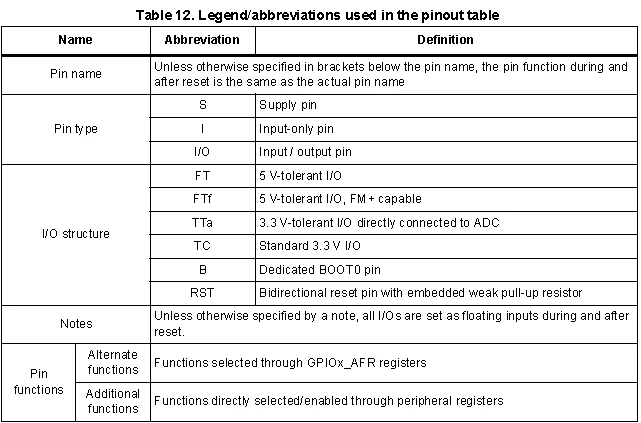

    A different part's (STM32F302xB) datasheet legend table has TTa indicating 3.3 V tolerant I/O directly connected to an ADC
    Max
    Feb 2, 2017 6:42 AM UTC
    Posted on February 02, 2017 at 07:42
    You should probably update your datasheet.
    http://www.st.com/content/ccc/resource/technical/document/datasheet/cd/46/43/83/22/d3/40/c8/DM00090510.pdf/files/DM00090510.pdf/jcr:content/translations/en.DM00090510.pdf
    Rev5 explains about TTa IO type in table 12:0690X00000605sNQAQ.png
    It also specify Absolute Maximum Ratings for this type of GPIO in table 21:
    as well as General operating conditions in table 24:
    You will also find a lot of data in the I/O port characteristics ...
