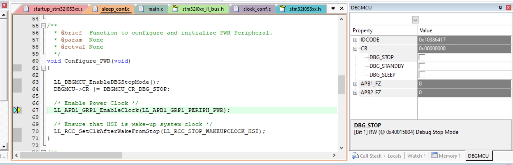

I am working with my custom PCB with STM32L053R8T6. My code works just fine when I run it in debug without any stop mode (deep sleep). It enters to the RTC and button interrupts perfectly. However, when I want to make the MCU enter to sleep mode the debug in Keil says:

I have attached the codes below. What can be the problem here? Can you help me.

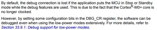

Hi @nicatali007 ,
Referring to RM0367, debug connections are lost when you are in stop mode:
So, before entering stop mode, you need to set the DBG_STOP bit to ensure the debugger remains connected.
 // Enable debug in STOP mode
 DBGMCU->CR |= DBGMCU_CR_DBG_STOP;
-Amel
July 9, 2024
Thank you for the reply @Amel NASRI . I checked the register and yes it was set to 0. However, it still doesn't change after I added DBGMCU->CR |= DBGMCU_CR_DBG_STOP; . Is there anything else I should do before changing this register
