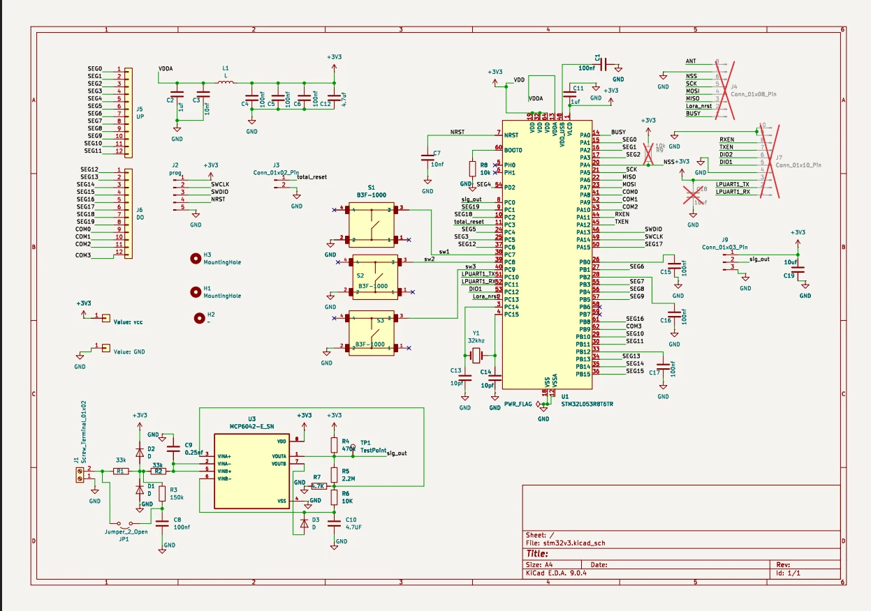

I'm working on a battery-powered flow meter application using the STM32L053, and I'm running into a massive, unexpected jump in power consumption.
Previously, our device was successfully hitting the 0.0xx mA (around 30µA) range while maintaining our sleep cycle and keeping the LCD on. However, our boards are now consistently drawing between 5.3mA and 6.0mA, and I am struggling to isolate the leak.

code - https://github.com/vedantjadhav304/BatterypoweredFLSTM32L

I have developed a custom board
I made a mistake by not storing working version , i added PVD and increase menu options for customization . I suspected PVD but after disabling it the problem is still there

hey , i was able to fig it out that the software is working fine but the controller was damaged by something . I soldered a new board with new stm it worked fine . Now i need to check why the stm’s are failing
There are many GPIOs going to the connector, without any protection, not even serial resistors.
And push buttons, same there, not even debouncing caps.
This might be no problem at all, as long you’re putting this together / using this in a completely ESD-safe environment.

Yeah , i agree this is just a proto i will add protection circuitry in the next revision

Hey guys i was able to identify and fix the issue . The problem was with the stm32l0 controller , earlier i mistakenly reversed the polarity of the batteries and damage Low powered section of the controller . I was unable to to consider this case before as the rest of the functionality of the project was working except low powered functionality
