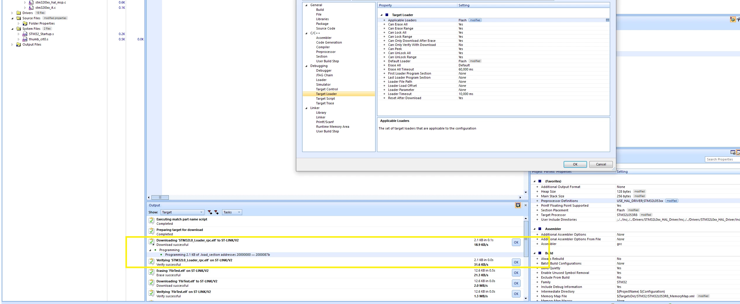

Hi, i manage to load it to the flash i think, however the reset button wont work when i use build and run. even I have set the STARTUP_FROM_RESET.
below is the download log:

it is targeting the ram which is 0x200000000 ++

Try examples in CubeL0, for instance one that blink LED/GPIO
Pick FLASH as the target​

How do you pick FLASH as the target ?
