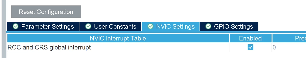

Aug 21, 2025 2:32 AM UTC
RTC_IRQHandler is not the handler for the CSS.
Is the interrupt enabled?
Should be a HAL_NVIC_EnableIRQ call somewhere. It's not in the code you presented.
Is HAL_RCCEx_LSECSS_IRQHandler defined? It's not in the code you presented.

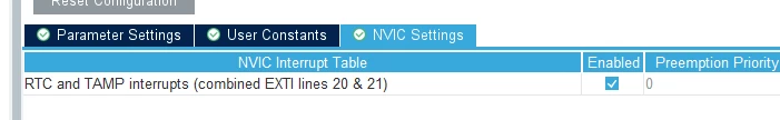

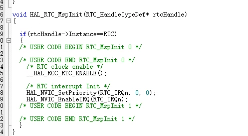

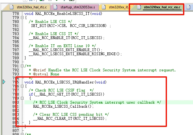

Aug 21, 2025 2:56 AM UTC
Thank you for your reply
RTC interrupt has been enabled.
HAL_RCCEx_LSECSS_IRQHandler  in the HAL library.
Aug 21, 2025 3:03 AM UTC
I don't see how the RTC or its interrupt is relevant here. Maybe I'm missing something.
