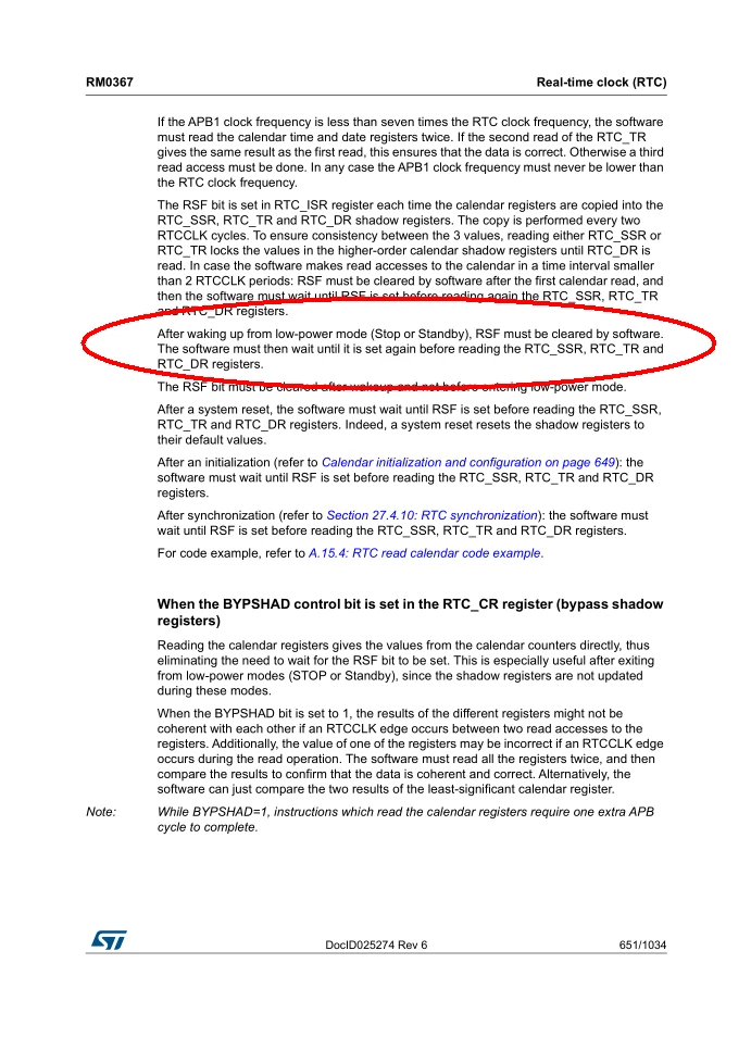

STM32L052 - RTC with implausible or Zero - Content after RESET due to leaving the standby mode by recognizing of level LOW on RTC-TAMP1 (PC13)
The tamper contact RTC.TAMP1 on PC13 is used for entering and leaving the standby modus in tamper - level - detection - mode. The detection of low level on RTC-TAMP1 finishes the standby mode and restarts the controller. That is all OK. but in about 30% of cases the test of RTC - data - plausibility fails. Either the RTC-shadow-registers contain implausible data e.g. seconds > 59 or all registers have the content = 0. VDD, VDD-USB and VDDA are all connected together and buffered by a battery. VDD dont't fall below 2,8V.

Hello Jan,
many thanks for our answer. Indeed I forgot to trigger the synchronizing of shadow registers an implemented the missing
instructions now:
void TriggerSynchroShadowRegs (void)
   WRITE_REG(RTC->WPR, 0xCA);      // Unlock the write protection
   WRITE_REG(RTC->WPR, 0x53);
   RTC->ISR &= ~(RTC_ISR_RSF);
   while (0==(RTC->ISR & RTC_ISR_RSF))
   WRITE_REG(RTC->WPR, 0xFF);      //Lock the write protection
But I couldn't realy remove the fault. Sometimes I read out false seconds
like "85" etc. It's a miracle.

Do you follow this procedure?
FEber.1
FEber.1AuthorBest answer
November 5, 2021

waclawek.jan
November 6, 2021
Reading out the RTC *before* going to sleep, using the same method, does result in always correct time?
How exactly do you read out and check it? Post code.

Hi Jan,
many thanks for the good hint.
Your suspicion was right.
The fault isn't cause during standby.
In case of reading the RTC before entering the standby mode the I found the error too.

Hi Jan,
the real solution of my originally problem was your hint concerning the treatment of RTC_ISR_RSF.
The other problem was a very embarrassing mistake of mine:
I always overlooked that the RTC keeps BCD values and not binary values.
The interpretation of BCD numbers as binary numbers then led to unexpected changes of the numbers.
Sorry for this stupid mistake!
