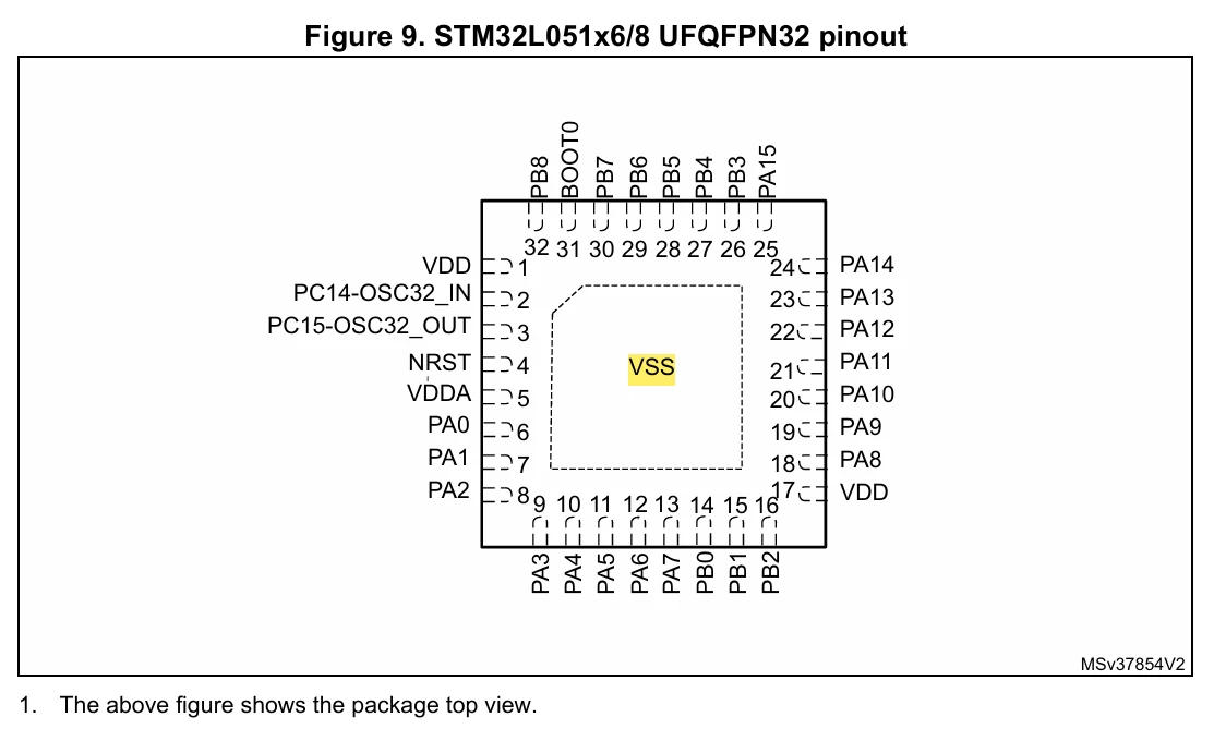

STM32L051K8U6 VSSA
Which pin is the VSSA of STM32L051K8U6?
1 reply
October 14, 2025
The UFQFPN32 package doesn't have a dedicated VSSA pin. The VSSA pin is double bonded to the VSS pin internally which is connected to the exposed pad.
