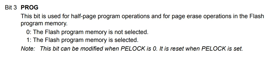

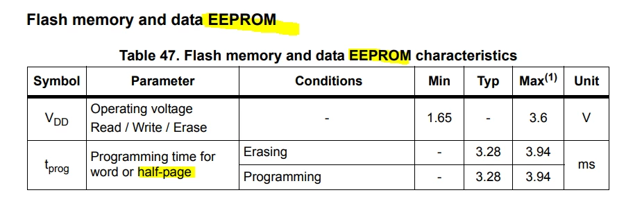

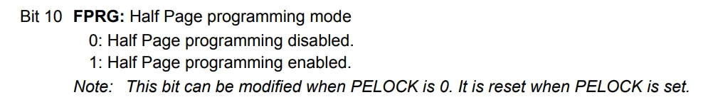

I'm using an STM32L051K8. I'm writing words to EEPROM. It takes a lot of time to do that. I read in the datasheet that it is possible to do a half-page write that will take the same amount of time as a single write.
How do I write a half page? Do I use the PROG bit and the FPRG bit?
Could someone share an example?
