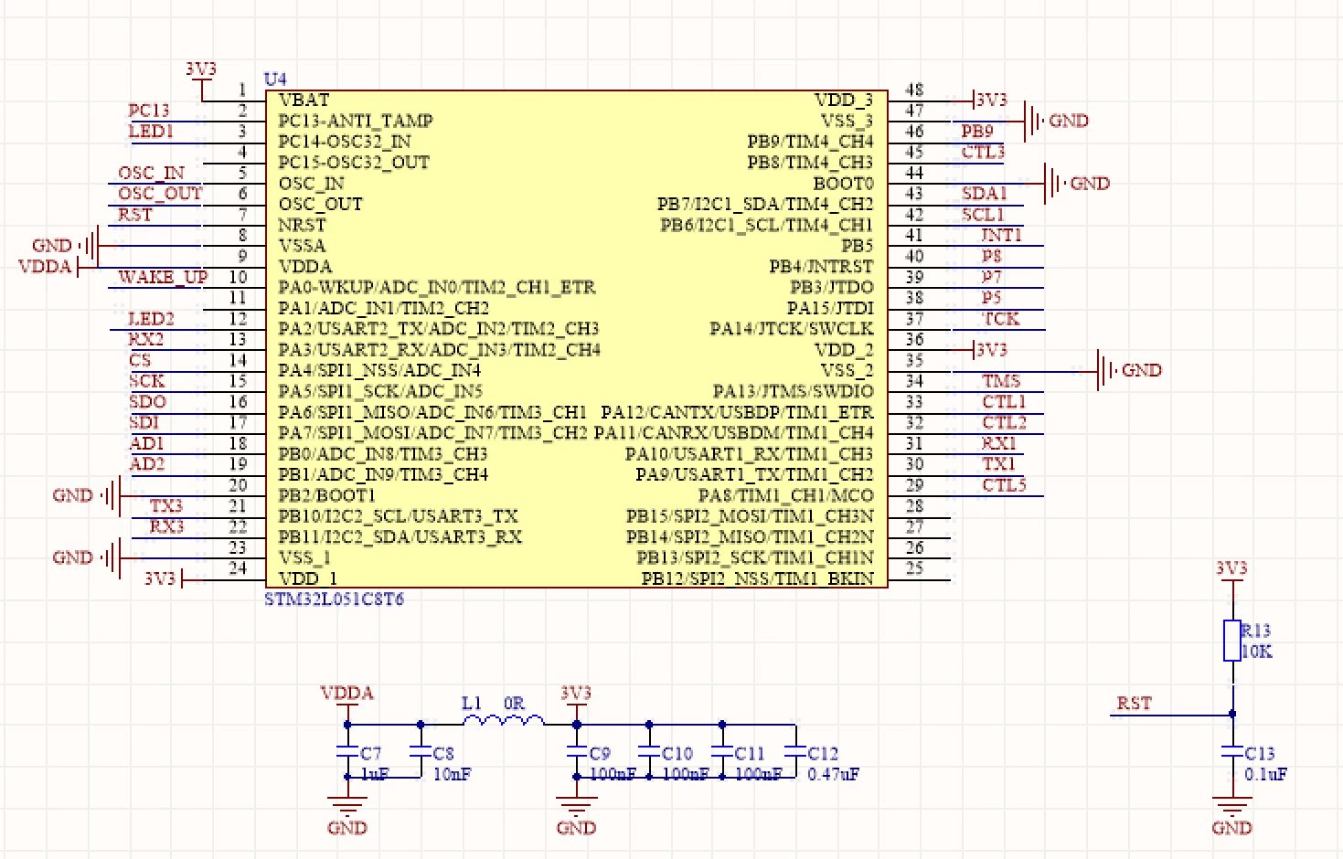

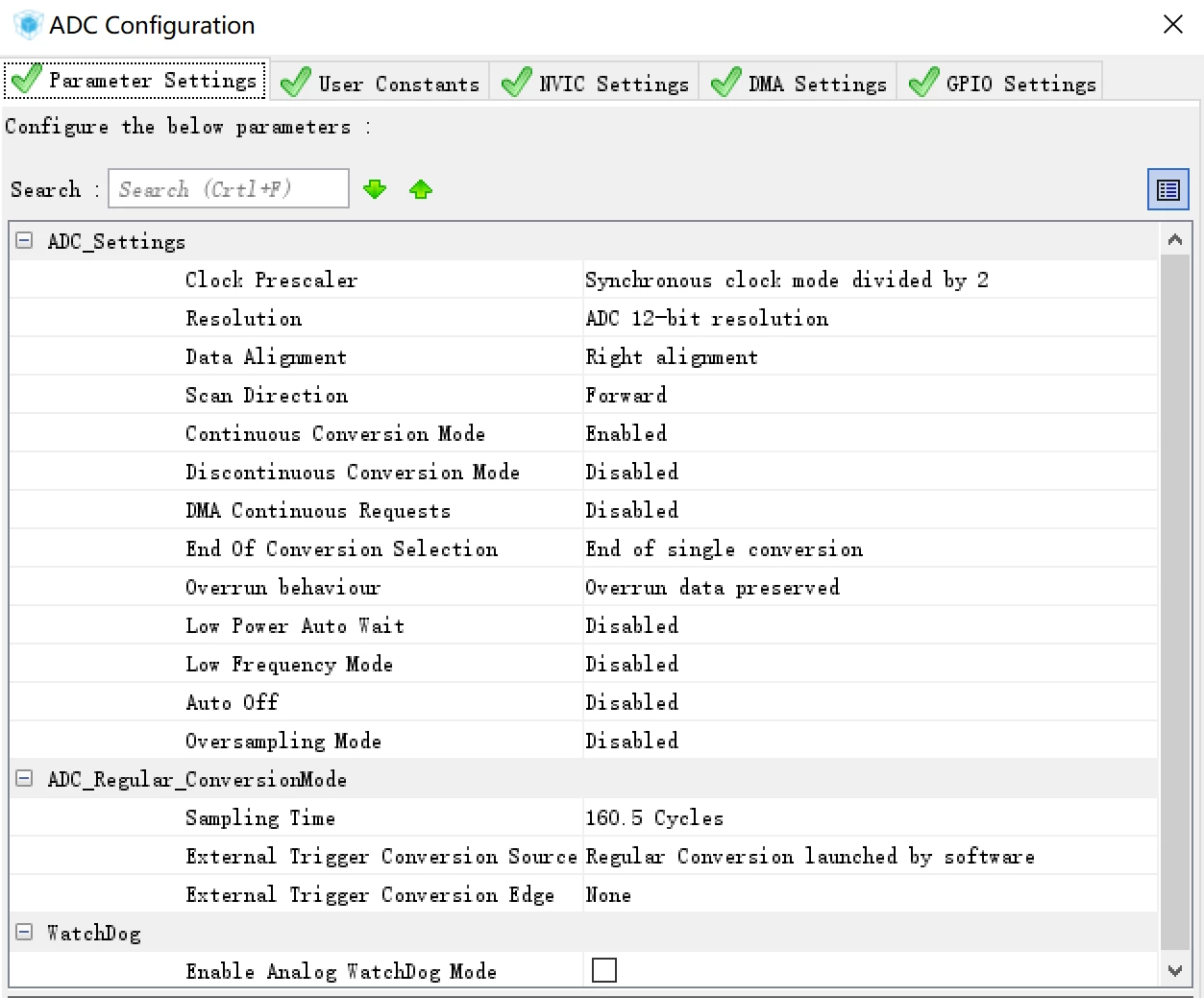

STM32L051C8 uses ADC to measure the voltage value. The measured voltage value of the AD pin is 0.432V,VCC=3.335V, and the voltage value obtained through AD collection is 0.48V; there is an error of 50mV, and the ADC part of the program and hardware are as follows:
0693W000006I984QAC.png0693W000006I99RQAS.png HAL_GPIO_WritePin(GPIOA, GPIO_PIN_11, GPIO_PIN_SET); //¿ªÆôºó²â�?¿9´®µçѹֵ
HAL_Delay(200);
HAL_ADC_Start_DMA(&hadc,(uint32_t *)ADC_ConvertedValue,2);
  HAL_Delay(100);
VCC1_r =(float)(ADC_ConvertedValue[0])*3.3/4096; // 9´®ºóµÚ1×éµçѹ
VCC2_r =(float)(ADC_ConvertedValue[1])*3.3/4096; // 9´®ºóµÚ2×éµçѹ

Peter BENSCH
January 11, 2021
Please read section 13.3.3 of RM0377, which describes the calibration of the ADC.
Please also replace 3.3 in your calculation with the actual value of the voltage at the VDDA, as the ADC references to this voltage and a deviation will add more error.
To get the actual value of VDDA it may be necessary to measure against a reference voltage, either internal or external depending on your requirements.
Good luck!

Thanks for the answer, after I use the actual measured VDDA value, there is still a big error.

Peter BENSCH
January 14, 2021
There are a number of adjustments that can be made to improve accuracy.
A good source for inspiration is AN2834: How to get the best ADC accuracy in STM32 microcontrollers.
/Peter
Ozone
Principal
January 14, 2021
>The measured voltage value of the AD pin is 0.432V,VCC=3.335V, ...
Your schematic shows VDDA is not connected to Vcc, so Vcc does not matter.
The ADC result depends on Vref, which is not necessarily VDDA.
Check the datasheet & reference manual.
