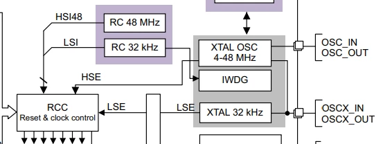

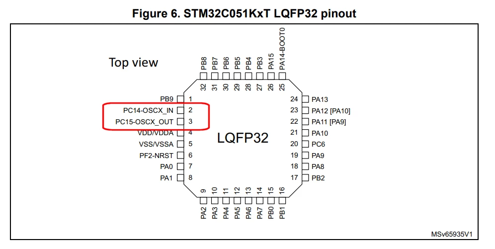

March 18, 2025
STM32C051K8T
Andrew Neil
March 18, 2025
Ah yes - that one has the shared OSCx pins:
OK as long as @MSipo doesn't also want the LSE ...
