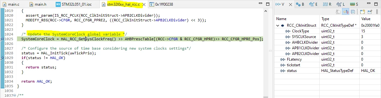

Hello folks,
I have an issue with STM32L051C8T6 - processor halt always on HAL_RCC_ClockConfig verification and have no idea where it's coming from.
I made a simple blink project with only two lines of code as a new CubeIDE project (all defaults) with a basic configuration:
* PB5, 8 & 9 are configured as output;
* Clock config with internal clock;
SystemClock_Config();
 /* USER CODE BEGIN SysInit */
 /* USER CODE END SysInit */
 MX_GPIO_Init();
 /* USER CODE BEGIN 2 */
 /* USER CODE END 2 */
 /* Infinite loop */
 /* USER CODE BEGIN WHILE */
 while (1)
 /* USER CODE END WHILE */
 /* USER CODE BEGIN 3 */
	 HAL_GPIO_TogglePin(GPIOB, GPIO_PIN_5 | GPIO_PIN_8 | GPIO_PIN_9 );
	 HAL_Delay(1000);
 /* USER CODE END 3 */
 * @retval None
void SystemClock_Config(void)
 __HAL_PWR_VOLTAGESCALING_CONFIG(PWR_REGULATOR_VOLTAGE_SCALE1);
 RCC_OscInitStruct.OscillatorType = RCC_OSCILLATORTYPE_HSI;
 RCC_OscInitStruct.PLL.PLLSource = RCC_PLLSOURCE_HSI;
 RCC_OscInitStruct.PLL.PLLMUL = RCC_PLLMUL_3;
 RCC_OscInitStruct.PLL.PLLDIV = RCC_PLLDIV_2;
 Error_Handler();
 RCC_ClkInitStruct.APB1CLKDivider = RCC_HCLK_DIV1;
 RCC_ClkInitStruct.APB2CLKDivider = RCC_HCLK_DIV1;
 if (HAL_RCC_ClockConfig(&RCC_ClkInitStruct, FLASH_LATENCY_1) != HAL_OK)
 Error_Handler();
The full Cube project is attached - any help is highly appreciated!!!
Many thanks!
Dave
Dave
BTW - I ran same code with Keil on simulation and the results are the same, so it's not board related.

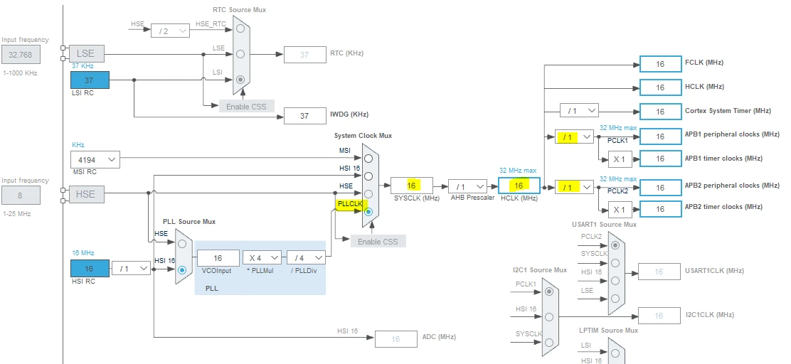

Hi folks,
Any help is GREATLY appreciated!
I set the MCU to 16 MHz using a PLL
0693W00000WL6MhQAL.pngwhere halt at the CPU initialization.
System Clock Configuration
System Clock source	= PLLCLK
HSI (mHz)		= 16
PLL Source		= HSI
PLL Mult		= 4
PLL Div			= 4
SYSCLK(mHz)		= 16
HCLK(mHz)		= 16
AHB Prescaler		= 1
APB1 Prescaler		= 1
APB2 Prescaler		= 1
VDD(V)			= 3.3
 RCC_OscInitStruct.OscillatorType = RCC_OSCILLATORTYPE_HSI|RCC_OSCILLATORTYPE_LSI;
 RCC_OscInitStruct.LSIState = RCC_LSI_ON;
 Error_Handler();
 if (HAL_RCC_ClockConfig(&RCC_ClkInitStruct, FLASH_LATENCY_0) != HAL_OK)
 Error_Handler();

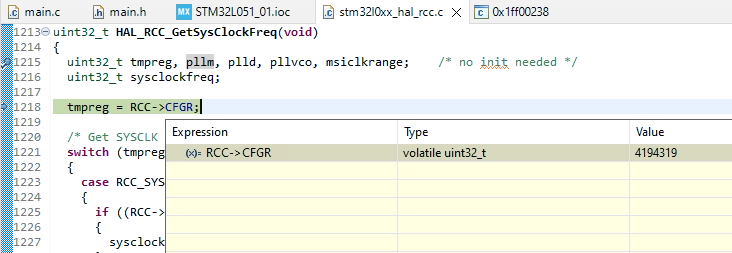

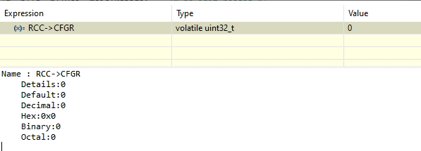

I decided to dig deeper and figure out exactly where it freezes
0693W00000WL6SmQAL.pngthen -> could not pass RCC->CFGR

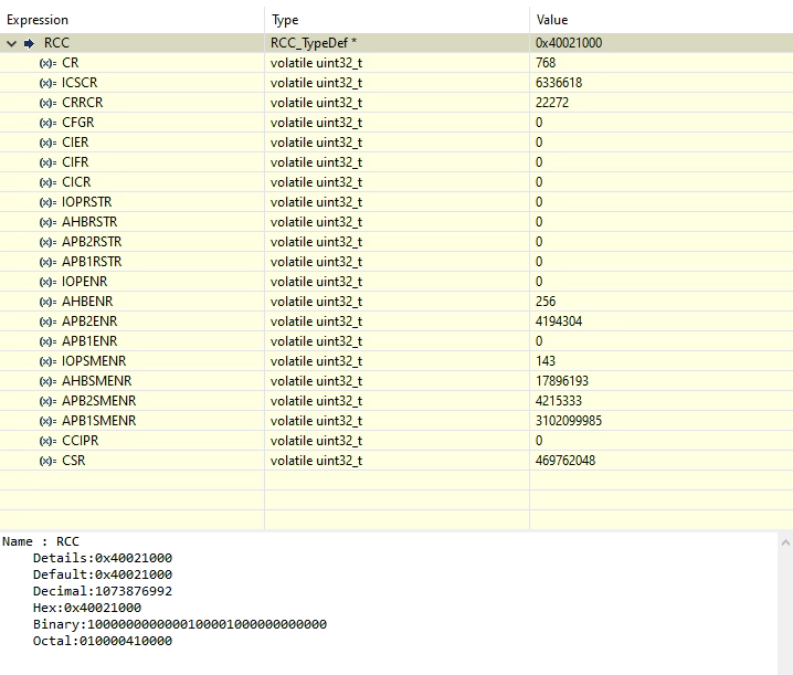

0693W00000WL6URQA1.pngCurrent values:
The complete project is attached as well.
