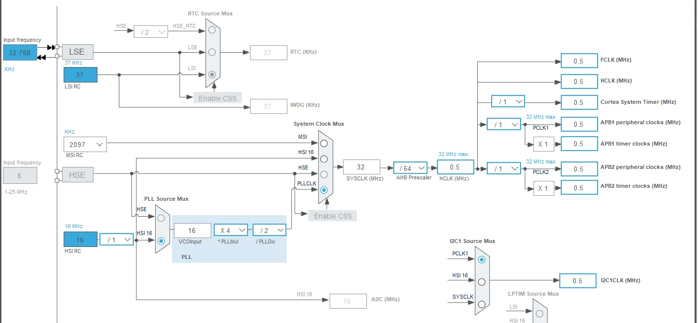

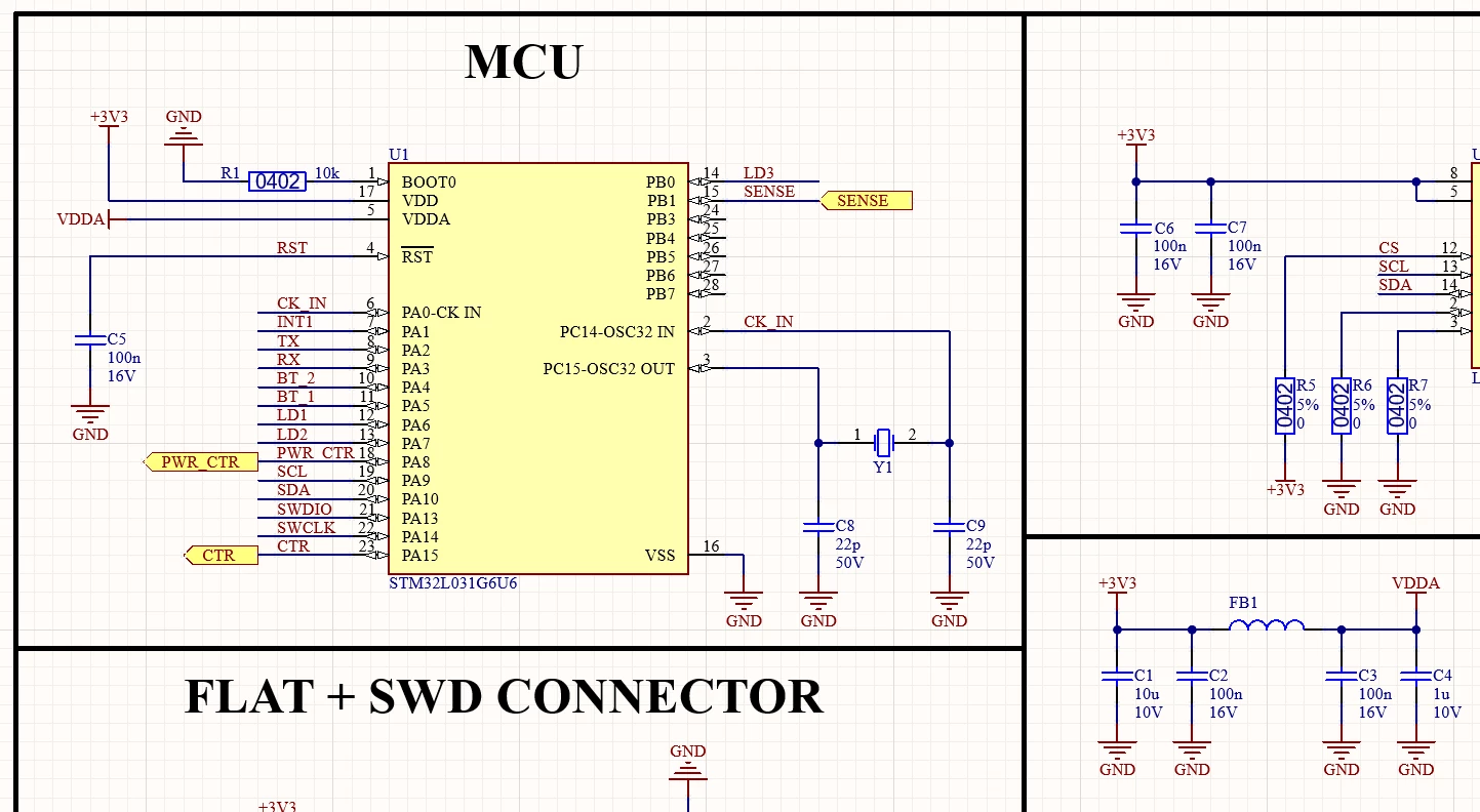

I have a problem with a STM32L031G in a custom board.
The program don't run after the program.
BOOT0 is connected to gnd via 10K resistor.
Attached you can find a circuit diagram and clock configuration.
what could be the problem?
Thanks
Michele
void SystemClock_Config(void)
 RCC_PeriphCLKInitTypeDef PeriphClkInit = {0};
 __HAL_PWR_VOLTAGESCALING_CONFIG(PWR_REGULATOR_VOLTAGE_SCALE1);
 RCC_OscInitStruct.OscillatorType = RCC_OSCILLATORTYPE_HSI;
 RCC_OscInitStruct.PLL.PLLSource = RCC_PLLSOURCE_HSI;
 RCC_OscInitStruct.PLL.PLLMUL = RCC_PLLMUL_4;
 RCC_OscInitStruct.PLL.PLLDIV = RCC_PLLDIV_2;
 Error_Handler();
 RCC_ClkInitStruct.AHBCLKDivider = RCC_SYSCLK_DIV64;
 RCC_ClkInitStruct.APB1CLKDivider = RCC_HCLK_DIV1;
 RCC_ClkInitStruct.APB2CLKDivider = RCC_HCLK_DIV1;
 if (HAL_RCC_ClockConfig(&RCC_ClkInitStruct, FLASH_LATENCY_0) != HAL_OK)
 Error_Handler();
 PeriphClkInit.PeriphClockSelection = RCC_PERIPHCLK_I2C1;
 PeriphClkInit.I2c1ClockSelection = RCC_I2C1CLKSOURCE_PCLK1;
 if (HAL_RCCEx_PeriphCLKConfig(&PeriphClkInit) != HAL_OK)
 Error_Handler();
It does run and then dies somewhere, silently?
August 13, 2024
It loads the code, but does not execute it. the first thing it has to do is light a led, but it does not do this
Tesla DeLorean
Guru
August 13, 2024
It does this in Reset_Handler() immediately at startup? Or somewhere much later in main() after SystemInit(), HAL_Init() and SystemClock_Config() ? Review ALL the code between Reset_Handler entry point, and the point where you've initialized the GPIO and illuminated the LED.
Skip SystemClock_Config() entirely, let the system continue to run at the clock it started on, and not the snail paced 500 KHz. Watch the 1KHz SysTick doesn't saturate.
Get something in Error_Handler() and HardFault_Handler() so the while(1) aren't silent.
BOOT0 is Low, so perhaps double check the validity of the Initial SP and PC in the Vector Table. Check Option Bytes if using those.
Use the debugger, stop the MCU, confirm where it's stuck. In your own code, or in the ROM.
