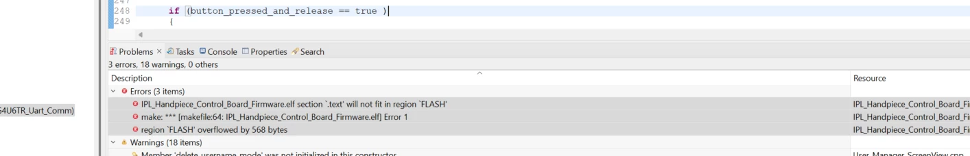

I have written a code where I am using,11 GPIO, 1 UART and Internat EEProm.
When I am building the code in I am getting below Error and not able to load the Application on STM32L011G4U6TR board.
If someone could guide how to resolve it, would be helpful. (Have removed the unnecessary arrays variables and using minimum variables to optimized ).
Description Resource Path Location Type
IPL_Handpiece_Control_Board_Firmware.elf section `.text' will not fit in region `FLASH' IPL_Handpiece_Control_Board_Firmware C/C++ Problem
make: *** [makefile:64: IPL_Handpiece_Control_Board_Firmware.elf] Error 1 IPL_Handpiece_Control_Board_Firmware C/C++ Problem
region `FLASH' overflowed by 568 bytes IPL_Handpiece_Control_Board_Firmware C/C++ Problem
Note when I am commenting some part of needed code then, I am able to load it and debug, but I need all the GPIO, UART, EEprom working together. Will do as per suggestions.

So it has only 16K of Flash.
The message tells you that you are 568 bytes over that:
That would reduce RAM use, but it's Flash that's overflowing - not RAM.
You need to reduce the code size.

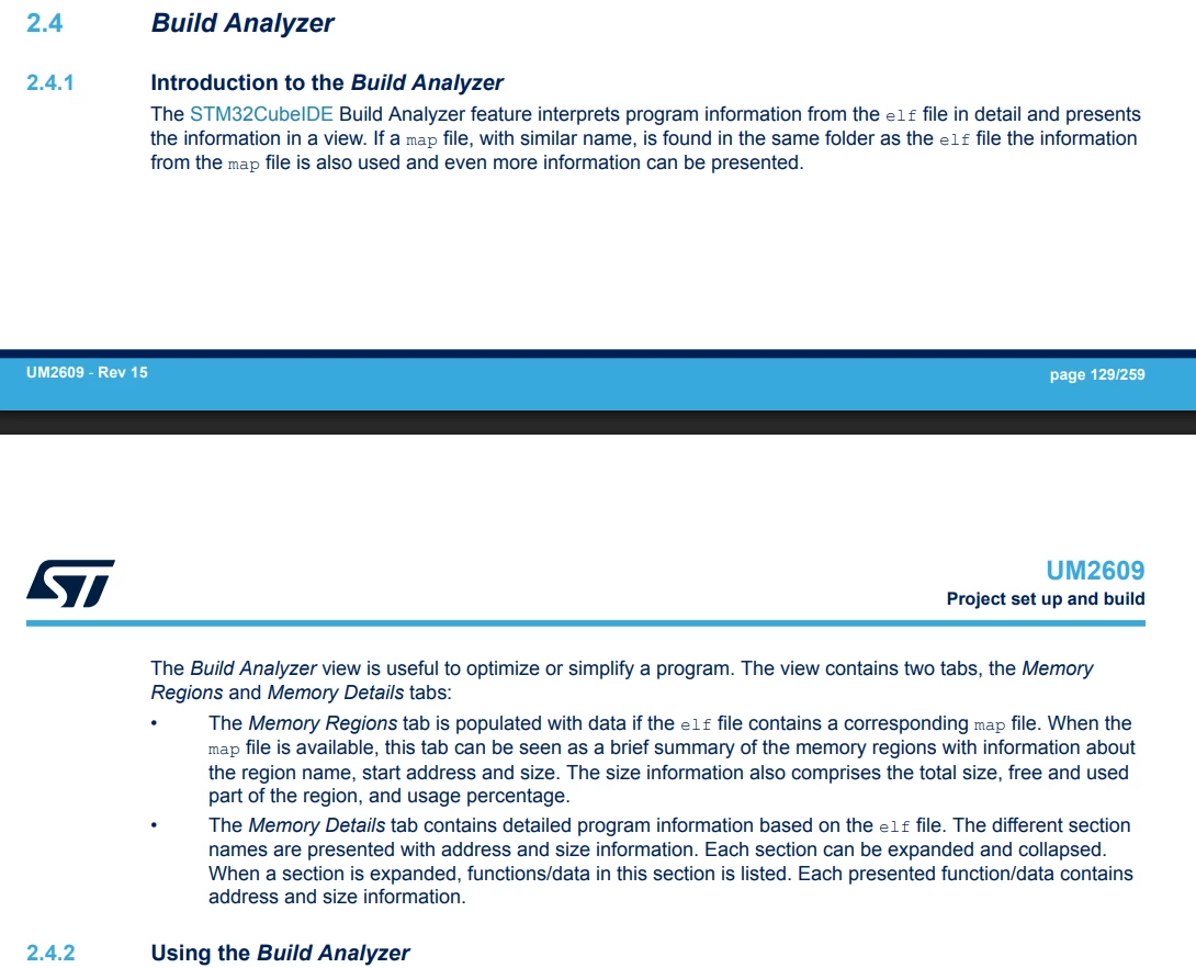

Use the CubeIDE Build Analyser to see what, exactly, is using up all the space.
common space hogs include
  • floating-point
  • printf
  • possibly HAL
As @TDK suggested, try a higher optimisation setting.
PS:
https://www.st.com/resource/en/user_manual/um2609-stm32cubeide-user-guide-stmicroelectronics.pdf#page=129

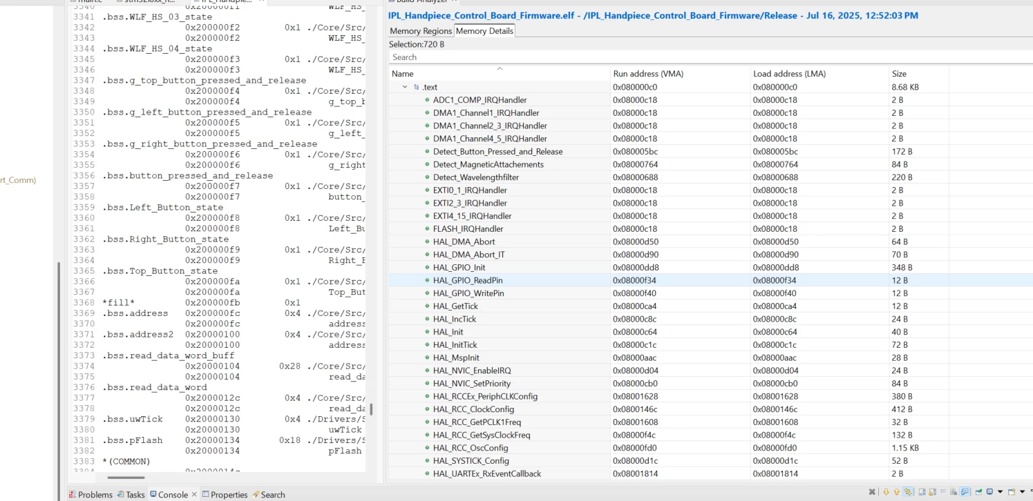

Thanks for the reply, Yes tried to go as per your suggestions, I can see the HAL functions and some Implemented functions (these having lower size), so any best possible way to optimize more and use the code ?
Andrew Neil
Andrew NeilBest answer
July 16, 2025
Try sorting the list by size, and look at the largest things ...
Have you tried increasing optimisation yet?
One key optimisation is that unused functions don't get included in the final image ...
GCC Optimisation levels are documented here;
https://gcc.gnu.org/onlinedocs/gcc/Optimize-Options.html
"-Og should be the optimization level of choice for the standard edit-compile-debug cycle, offering a reasonable blend of optimization, fast compilation and debugging experience" - see here.
