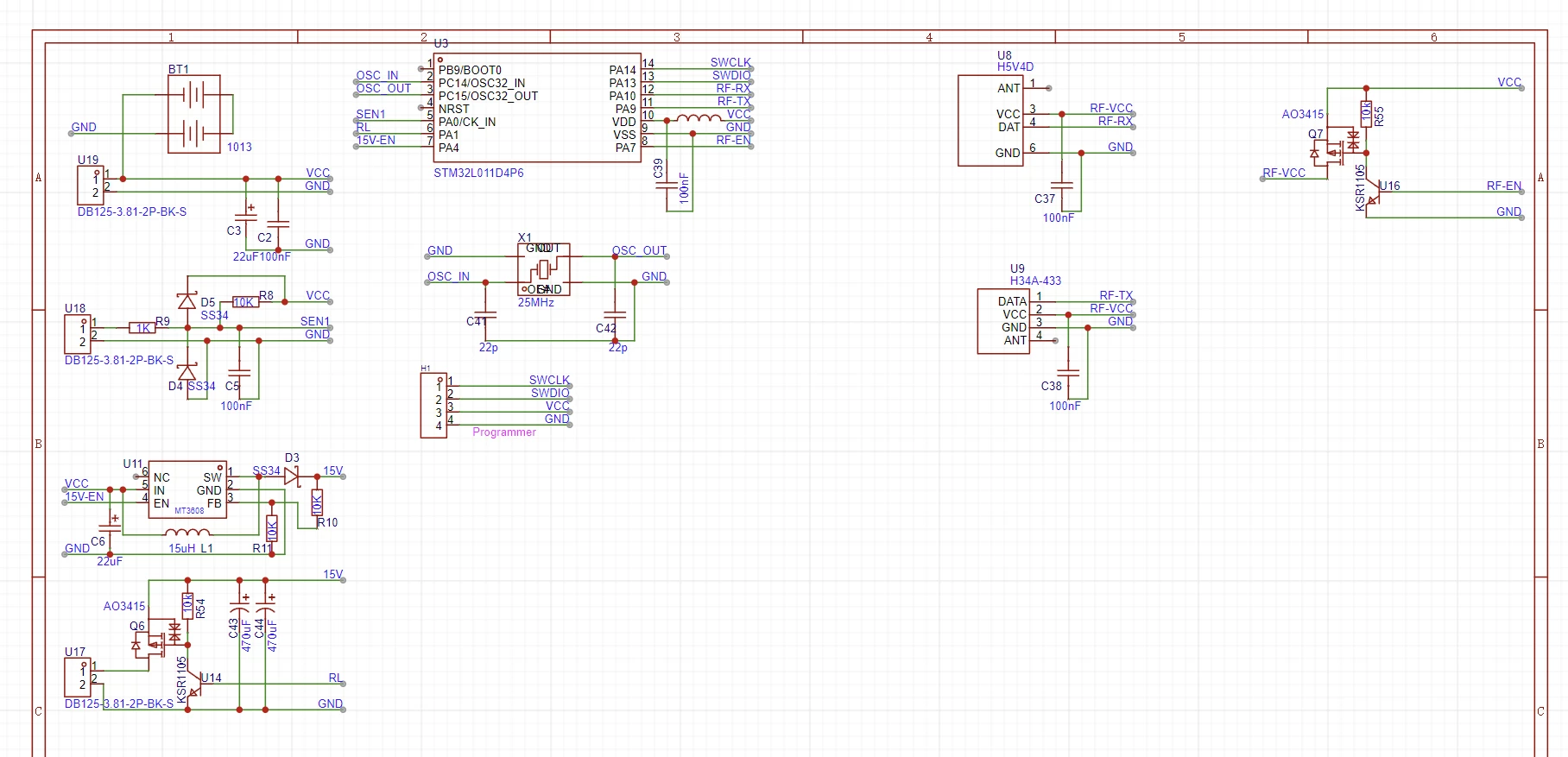

I have STM32L011 board that i make. I left NRST and BOOT0 open. And i try to upload code using ST Link V2. But seem like the ST link is not recognize the STM it always show "Target no device found". Can anyone help me identify the problem? Please..Thank you in advance.

Present schematic
Error tends to be indicative of non-functional part, often due to power issues, or the VTarget not being presented to the ST-LINK/V2 (Pin 1 of 20-Pin Header)

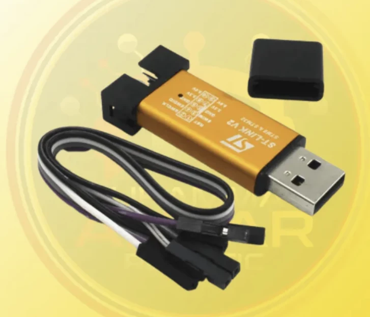

This is both circuit diagram and ST Link i used. For ST link i try with the board i bought (STM32F401C) is working fine but it not working with STM32L011. Can you help me? Also if you need more information please let me know. Thank you so much

Yes, so that's a boot-leg ST-LINK, using ST-LINK Utilities, or newer STM32 Cube Programmer?

Nothing is jumping out immediately from the schematic, and you can read 3.3V across the supply at the capacitor?

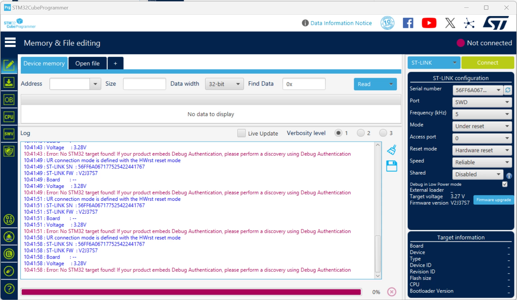

Sorry that i can't provide you with testing image because i don't have a board with me now. but tomorrow. I will send you all testing picture. Also i confirm by read direct on NRST pin is 3.3V, for BOOT0 pin i also try to pull them to low. But seem nothing work. I even try to replace the STM32 chip but still the same result. :(
Esa1Author
November 13, 2024
This is the image of CubeProgrammer. I try put pin NRST to low while trying to connect. It seem can detect that the chip is in RST state.

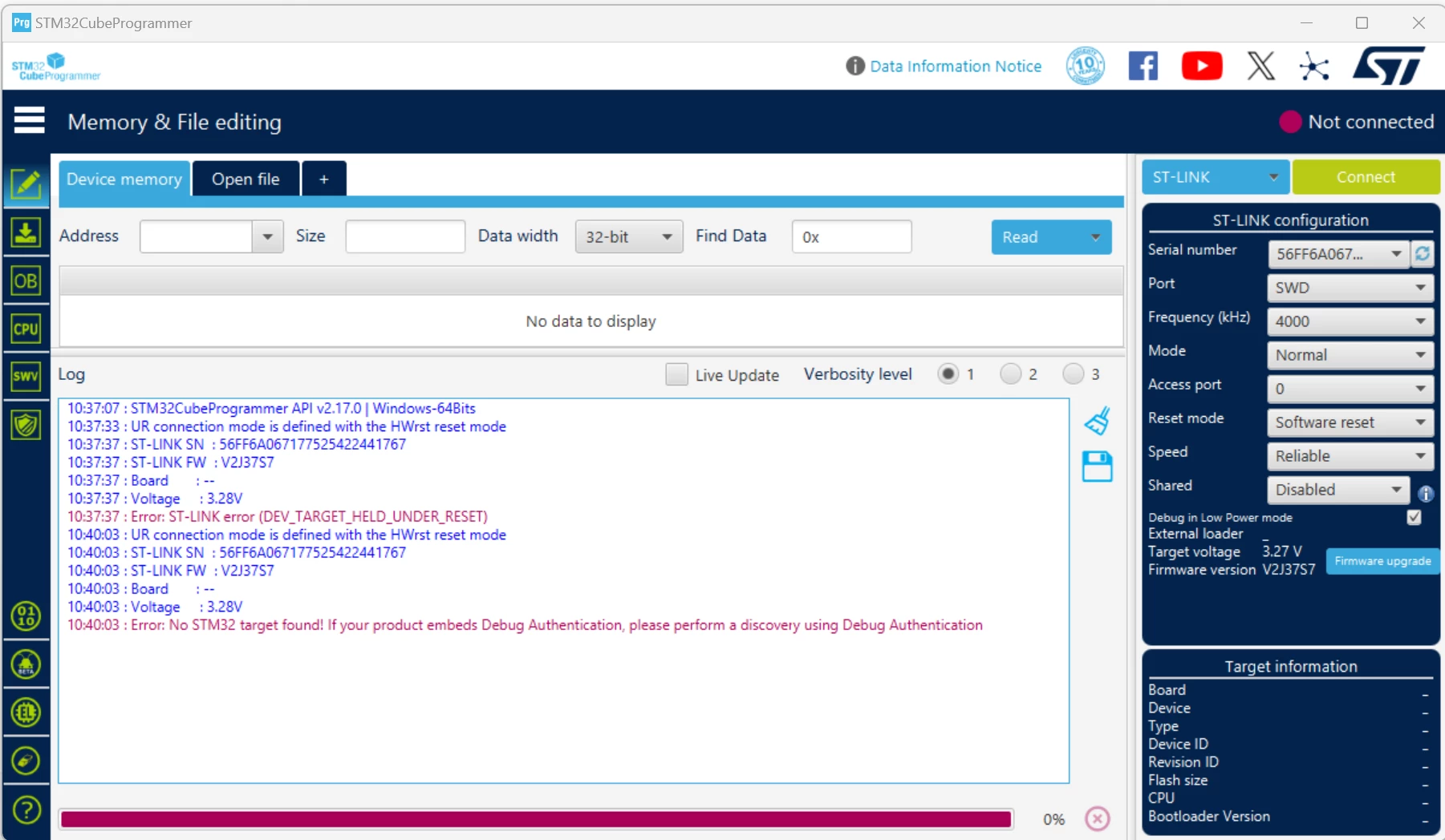

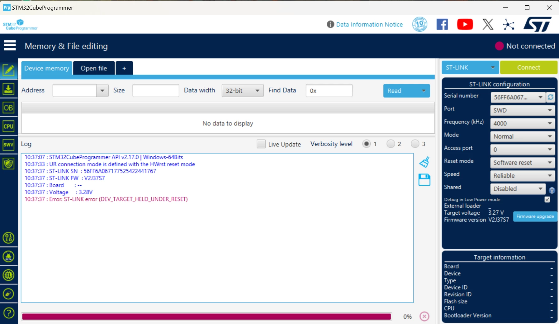

Esa1Author
November 13, 2024
And when i try again is still the same result. Connect NRST to ST link or not is the same
Esa1Author
November 13, 2024
The same result when i try to decrease speed to the lowest and select under RST
