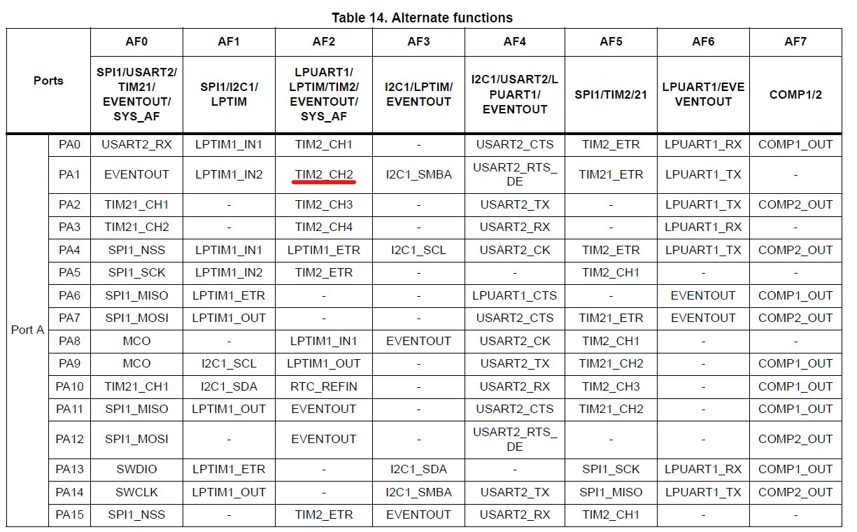

Select PA1 as TIM2 CH2, those code are copy from ST official example(TIM21), and changed to TIM2.
no output from PA1, code as below:
void ConfigureTIM2AsPWM_EdgeAligned(void)
/* (1) Enable the peripheral clock of Timer x */
/* (2) Enable the peripheral clock of GPIOA */
/* (3) Select alternate function mode on GPIOA pin 1 */
/* (4) Select AF2 on PA1 in AFRH for TIM2_CH2 */
RCC->APB1ENR |= RCC_APB1ENR_TIM2EN; /* (1) */
RCC->IOPENR |= RCC_IOPENR_GPIOAEN; /* (2) */
GPIOA->MODER |= 0X00000008; /* (3) */
GPIOA->AFR[0] |= 0X00000020; /* (4) */

@STM32L09,
> TIM2->CCR1 = 4; /* (3) */
does not set TIM2_CH2 but TIM2_CH1. You would spot it yourself, would you print out and check the TIM2 registers content.

KnarfB
May 11, 2025 8:05 PM UTC
The |= is wrong for MODER (and in general for AFR too). You need to set some bit(s) and clear other(s).
A general pattern is
GPIOA->MODER = (GPIOA->MODER & ~GPIO_MODER_MODE1_Msk) | (2 << GPIO_MODER_MODE1_Pos); // alternate mode
or some macros wrapping that.
hth

STM32L09Author
May 12, 2025 12:44 AM UTC
thanks, KnarfB, I realize default value for MODE is 0XFFFF FFFF, so I should clear some bits.
but seems still have other problems, still no PWM.

I use USART2 to print the register value, the value is HEX format.
GPIOA->MODER:EBEBFCF9
GPIOA->AFR[0]:20
PA1 configuration is correct.

STM32L09Author
May 13, 2025 12:54 AM UTC
Many thanks, it works now.
