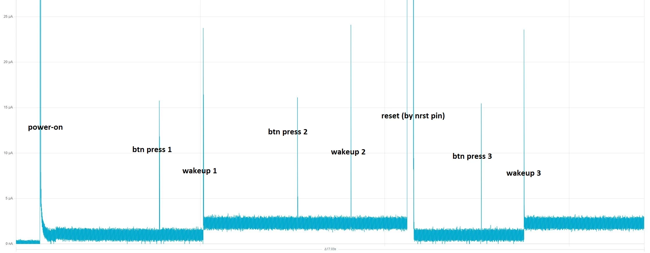

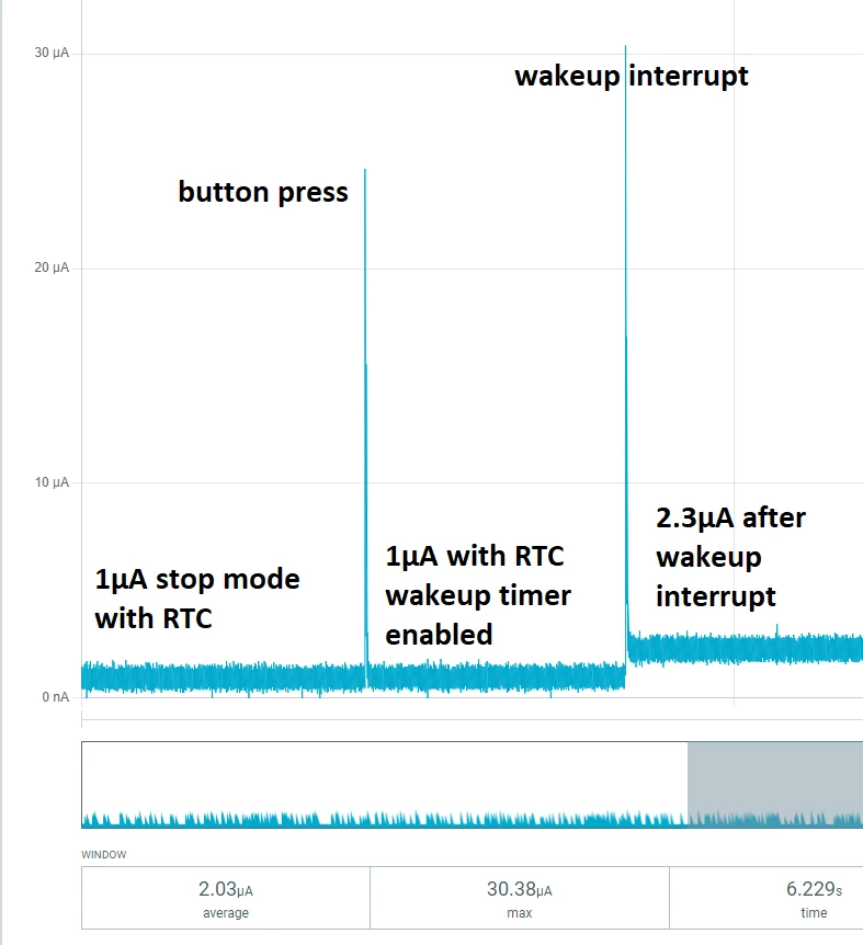

I noticed the current draw of my STM32L011 increases after returning to stopmode from a RTC wakeup timer interrupt. The current remains higher until a reset is performed. I've narrowed it down to a minimal bit of code that reproduces the problem however I haven't found a way to avoid or fix the issue. The errata don't mention anything like this either.
This is a trace of the current consumption, I've also attached a longer trace that includes power-on and a reset after the wakeup
rtc wakeup currentrtc wakeup current
This is with only the LSE, RTC and an input pin configured. Code to reproduce the issue:
