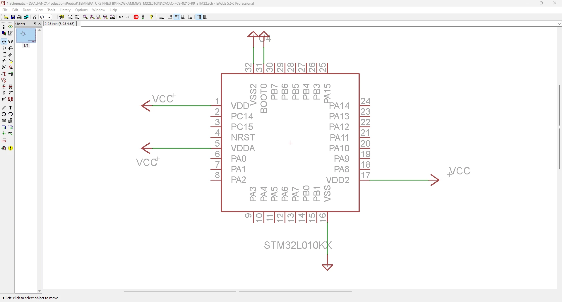

I have tested the kit discovery  NUCLEO-L010RB and the program PWR STANDBY(mcu STM32L010RB), this work fine. I would like do exactly the same test with the mcu STM32L010K8 (so the same family like STM32L010RB), but I have a problem, the program run well but the current consumption is always at about 2mA instead 1.8uA in standby mode.
I use the KEIL for the development. Nothing else is connected in the STM32L010KB, just VDD, VSS and VDDA like the picture in attachment.
Have you an example with KEIL to test the STM32L010KB in standby mode please?

  • What hardware are you using? Show schematics.
  • What were you expecting to observe?

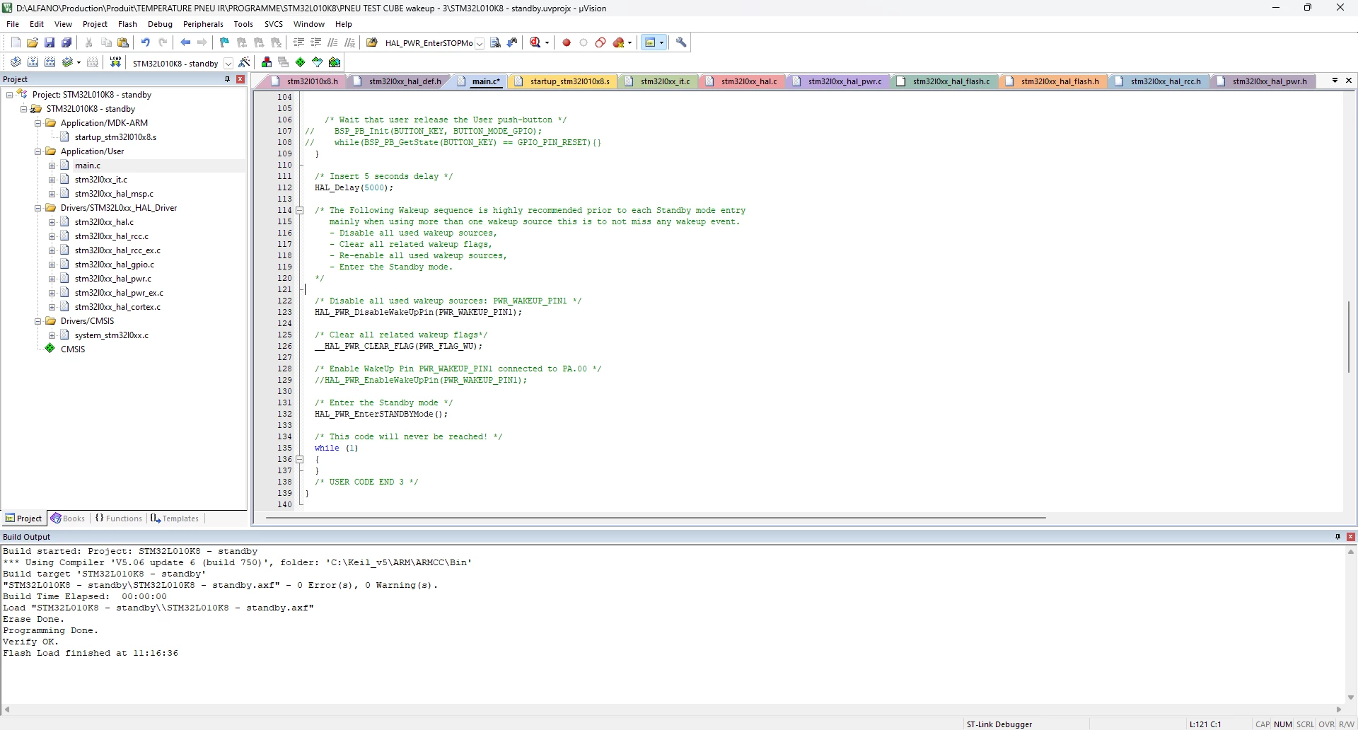

NonotiboyAuthor
December 11, 2024
Thanks for your response.
The result is the same when I remove physically the debugger, always about 2mA.
I remark something strange, In the kit NUCLEO-L010RB, this bit DBG_STANDBY is reset, but in my program the DBG STANDBY is always set, I cannot clear DBG_STANDBY (I have added the code below) !
Please see the picture in attachment.
This but could be the problem?
	 HAL_Delay(500);
	HAL_DBGMCU_DisableDBGStopMode();
	HAL_DBGMCU_DisableDBGSleepMode();
	HAL_DBGMCU_DisableDBGStandbyMode();
