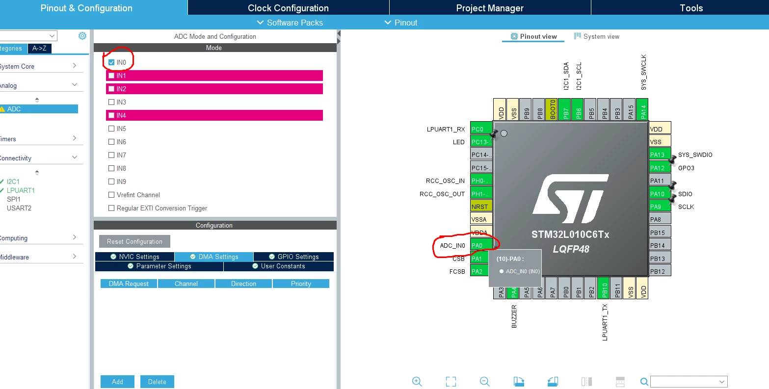

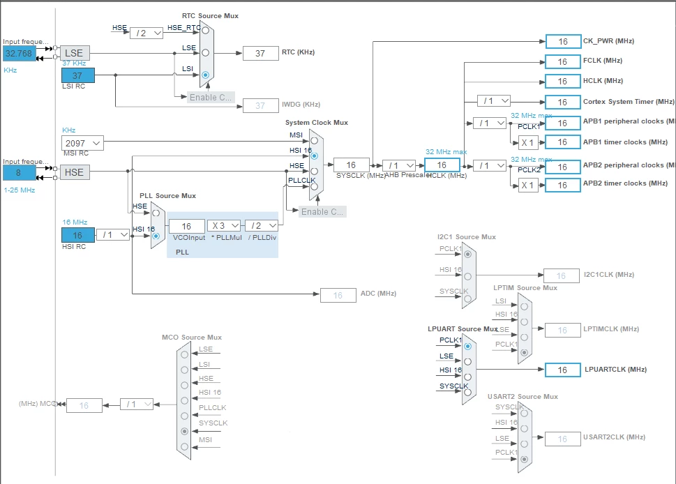

ZKURT.1
ZKURT.1Author
Senior
February 3, 2022
0693W00000JOMbcQAH.png0693W00000JOMbSQAX.pngOf course there are examples I found, but I couldn't get it to work. For example, in your example, the program works once and does not work again. It works with the Standby reset logic I know. After 10 seconds it should work again but it doesn't. Why do you think it might?
