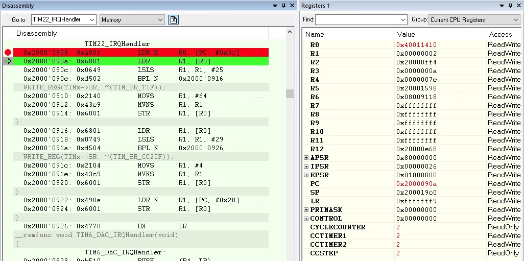

Alexandre Courtemanche
January 7, 2022
If I look at the disassembly of the ISR, there is absolutely no access to flash at all. Everything is in RAM (0x2000000) or timer peripherals (0x4000000).
