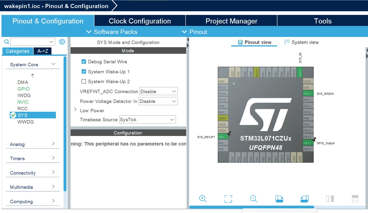

STM32L0 wake up pin 1 (PA0) not working?
I would like to use system wake-up pin 1 (PA0) as an external interrupt to wake up my MCU from standby mode. Understand that a rising edge on PA0 (wake-up pin 1) should trigger the MCU to exit standby mode. However, I am encountering difficulties in waking up the MCU using this pin. The pin configuration is shown in the attached picture.
Circuit: Supply high voltage to VIN (5V)to wakeup MCU.

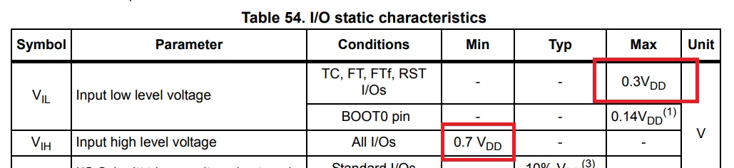

I may suggest to decrease the values of the resistors.
Your divider generates this voltage level: 5 V x (549/(549+976)) = 1.8V
According to the datasheet:
VIL max = 0.3 x 3.3V = 0,99V
VIH min = 0.7 x 3.3V = 2,31V
Your generated output voltage is neither seen as Low level nor high level voltage as it is seen as an undefined state.
Need to recalculate the resistors value to fit VOUT < 0,99V for low level and VOUT > 2,31V for high level
Also I recommend to decrease the values of the resistors: 549K and 976K are very high.
