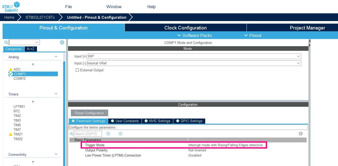

Currently I am unable to force the COMP1 interrupt, so I assumed the internal VREF is not turned on- could you help me turning it on in case that is the issue? I have set it as the COMP "-" input source.
KDJEM.1
September 16, 2022
Hello @Community member​ ,
If you use the STM32CubeMX, make sure that select the interrupt mode with Rising/Falling edges detection in Trigger mode as shown in the below figure.
Also, I advise you to get inspired from the available COMP_Interrupt example in the STM32CubeL0 MCU package.
This example may help you in the configuration by following the instructions in the readme file.
