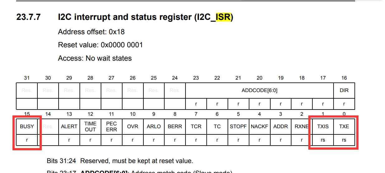

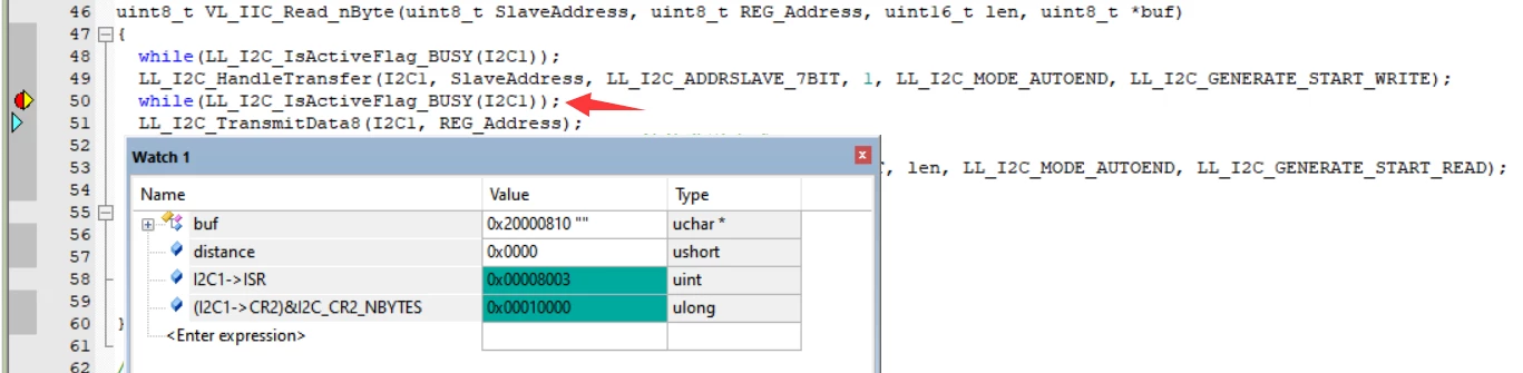

STM32L0 uses I2C to send the slave address, it gets stuck at ISR=0x8001.
STM32L051K8U6
The code always gets stuck here
This situation is likely due to the slave not responding to the address, but with the same hardware, using software-simulated I2C communication works perfectly fine.I have already checked, the slave addresses sent out by both sets of code are the same.
I2C has been enabled with a frequency of 200kHz,The pull-up resistor is 2.7kΩ.and the initialization code was generated by CubeMX. I don't think there should be any issues with this part

You're in the middle of a transfer. The master is holding SCL low while waiting for you to send it data in which case BSY will stay set. Why are you waiting for it or expecting it to be cleared?

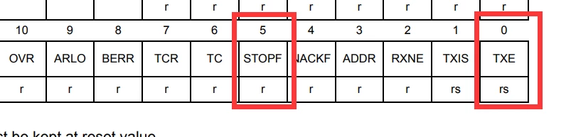

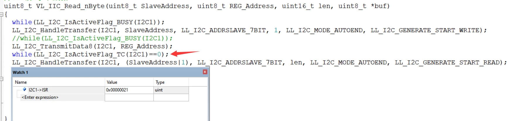

I want to wait for it to send the slave address, or does he wait until he sends the first data before appending the slave address? Now I've commented out the code waiting for busy. But now it gets stuck waiting for the data to be sent, which is very strange, and I can't understand it.
If it has already finished sending and automatically stopped, why isn't the TC flag set?

You are expecting things to happen that aren't grounded in the reference manual. Look through the reference manual to understand when TC is set. It is very explicit about it. Or look at HAL code to understand how it's done there.
