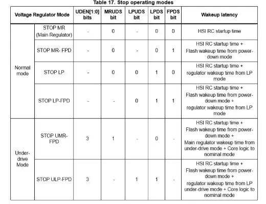

I have some questions.
I read that STOP mode has a "RAM retention", so when it wakes up it the whole data is still intact (not cleared).
When the RAM retention is off then the data is gone when it goes to STOP mode. So when it Wakes up does it restart the whole program and starts from the beginning ? Initializes all GPIO, peripherals, basically starts the program from includes down to the main loop.
Standby mode is similar to no Ram retention STOP mode as I interpreted it correctly. That is start the whole program again.
I have a problem understanding what STOP and STANDBY modes do when STOP mode has no RAM retention on.
And what each of these STOP modes does because I don't know which one is without RAM retention.

Different STM32 families handle RAM retention in STOP mode differently. For instance: In STM32L4 STOP0 and STOP1 retain all of the RAM, while STOP2 may power down part or all of the RAM to save power. In STM32H7 series has additional configurations with finer control over RAM banks and retention.

And how no RAM retention works ? And how to enable this option to turn of RAM retention ?
If no RAM retention works the way that when it wakes up it restarts the whole program then it works the same like STANDBY mode which means what is the difference ?
And the picture of a table I have sent have different STOP modes which I don't understand what effect they give in the program.
HAL_PWR_EnterSTOPMode(PWR_LOWPOWERREGULATOR_ON, PWR_STOPENTRY_WFI);
only has two options its either PWR_LOWPOWERREGULATOR_ON or PWR_MAINREGULATOR_ON, they retain the RAM so for the program it gives no difference ? The all peripherals still works the same does not need to initialize again. Only the power source is the difference I guess.
But how to enter no RAM retention in this HAL function ?

You miss here. Primary your table is about time to start code back from STOP...
RAM retention is irelevant here and in normal STOP usage you place requred variables into RAM with retention and all other is lost , but not require reinit or any mcu cycle.
STANDBY after wake always reset MCU by hw, STOP never or sw based. RAM is not managed with same command as STOP start...
And last info after STOP wake some reinit is required based on MCU , but allmost require reinit PLL when used.
