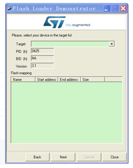

stm32l0 program sorftware
Posted on December 27, 2016 at 04:08
I  choose the device that is stm32l031f6 in my project,but i can'i find a suitable software to load my proogram,i try flash demo v1.1.1,v1.3 and v2.80 to do it ,but they are all failure,as seem as the mcuisp and flymcu ,which only program one times.so i want to know whether my opreration or software problems?

Hi
I am pleased to inform you that you may keep using same initially selected device: STM32L031F6.
The attached release candidate of the STMFlashloader (V2.9.0) is supporting this product.
Could you please test it and let us know if you have any feedback?
The official release of
will be available on January 2
-Amel-

Older software, ST should refresh

Posted on December 28, 2016 at 04:09
Thank you very mach,Clive one;Although,it is not a good message for me.I think i should choose anather MCU for my design;
