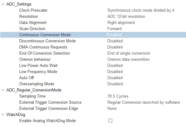

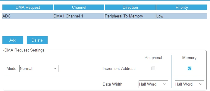

I am trying to read 2 channel ADC with STM32L011F4.
My ADC and DMA settings in cubemx are as follows0693W00000NpJS3QAN.png0693W00000NpJSIQA3.png
my problem is that the DMA only returns the low 8 bit of the last channel.
uint16_t ADC_Reads[2] = {0};
	while (1)
		HAL_ADC_Start_DMA(&hadc,(uint32_t *)ADC_Reads,2);
		HAL_Delay(1000);

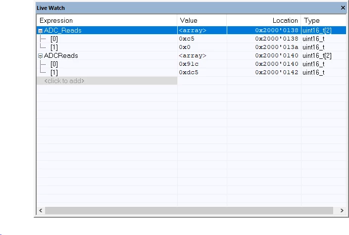

When I write the following code in the DMA IRQ handler, I can read the values.
uint16_t ADCReads[2];
char i=0;
void DMA1_Channel1_IRQHandler(void)
 /* USER CODE BEGIN DMA1_Channel1_IRQn 0 */
ADCReads[i] = hadc.Instance->DR;
	i = 1-i;
 /* USER CODE END DMA1_Channel1_IRQn 0 */
 HAL_DMA_IRQHandler(&hdma_adc);
 /* USER CODE BEGIN DMA1_Channel1_IRQn 1 */
 /* USER CODE END DMA1_Channel1_IRQn 1 */
EWARM live watch screen looks like below

Lots of people had issues wth this, including me.
Try this out:
HAL_ADC_Start_DMA(&hadc,(uint32_t *)ADC_Reads, sizeof(ADC_Reads)/sizeof(ADC_Reads[0]));
or
HAL_ADC_Start_DMA(&hadc,(uint16_t *)ADC_Reads, sizeof(ADC_Reads)/sizeof(ADC_Reads[0]));

it didn't work result is same
