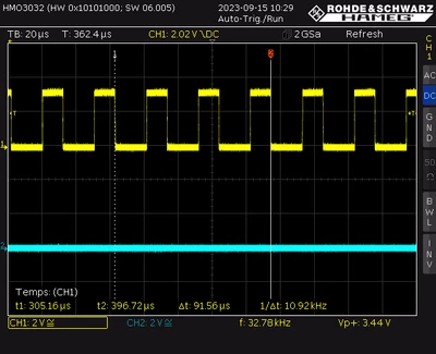

When i check my bauds rate on my oscilloscope, i get the value of 93.3 that represent ~10718 bauds.
I have try to modifiy load capacitor of my resonnator (12pF and 6pF) but no change.
Do you have advice about this error in baud rate ?

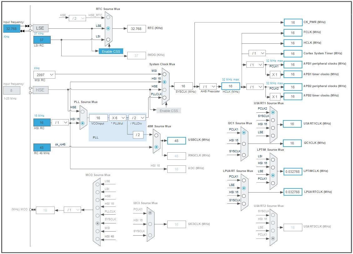

My clock configuration in STM32CubeMX:

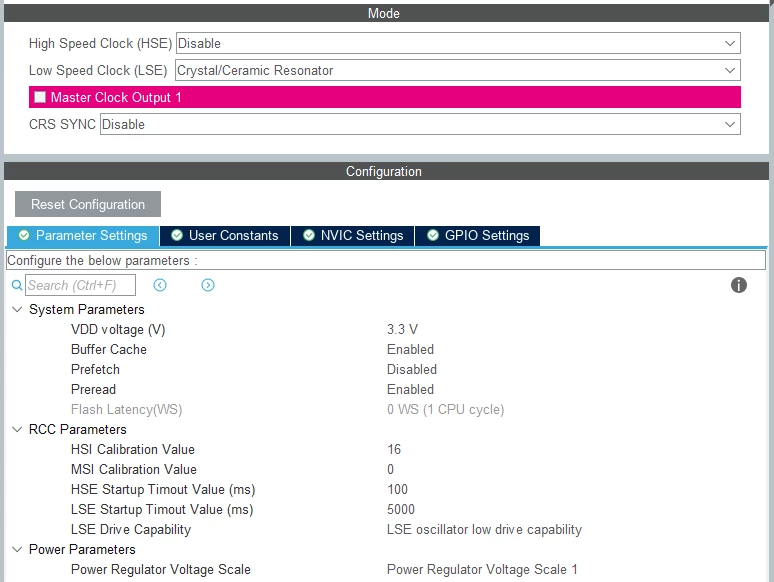

My RCC configuration:

If you measure individual bits, you can only measure integer periods of the 32768Hz LSE clock, i.e. the calculated "baudrate" from individual bits can be for 9600 setting only 32768/3=10922 or 32768/4=8192. LPUART achieves a relatively good 9600 Bauds by dithering, i.e. alternating appropriately between these two bit lengths.

1) Frequency is correct, Picture below get from MCO output
2) I have try in High LSE drive capability but nothing change.
