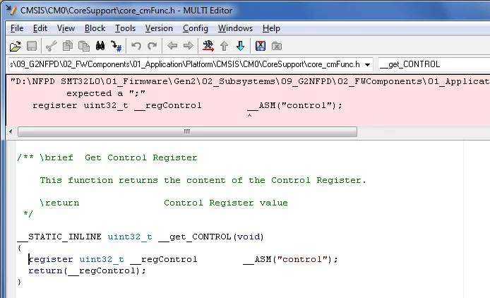

Hi Guys,
I´m trying to compile a simple custom project in GreenHills but I´m getting some kind of problems.
I´m developing a project with STM32L0C52 uC.
core_cm0plus.h
#if   defined ( __CC_ARM )
  #define __ASM            __asm                                      /*!< asm keyword for ARM Compiler          */
  #define __INLINE         __inline                                   /*!< inline keyword for ARM Compiler       */
  #define __STATIC_INLINE  static __inline
#endif
core_cmFunc.h
__STATIC_INLINE uint32_t __get_CONTROL(void)
  register uint32_t __regControl        __ASM(''control'');
  return(__regControl);
My question is. Are STM32L0 Libraries set to MULTI Compiler??
    1 reply
    Tesla DeLorean
    Guru
    November 7, 2014
    Posted on November 07, 2014 at 17:00
    __CC_ARM is defined for ARM (Keil & RealView) compilers.
    You will need to create some suitable MACROs or DEFINEs for GHS, for the inline function, and inline assembler directives. Given the amount of a GHS license perhaps you should get their support staff to walk you through integration of ARM CMSIS libraries?
    Check also your compiler documentation. Not a lot of GHS MULTI users here, perhaps some are lurking?
