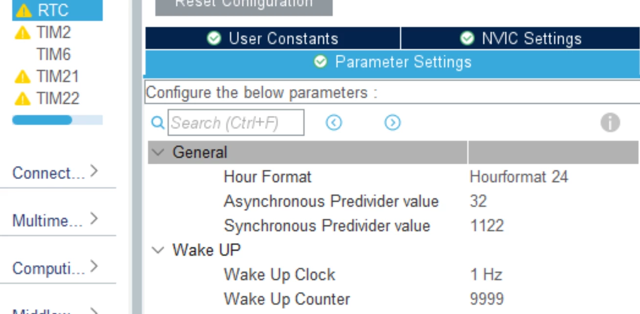

Using RTC with LSI Clock, BinaryMode and 24h Format.
HAL_RTC_GetTime/Date returns unpredictable values after stop mode crossing midday or midnight:
  1. hours value above 24h. see a)
  2. "pm" (Timeformat "64") in 24h Mode, which is sometimes wrong additionally, which prevents correction. see b & c

Does the real wakeup time match the expected time?
What is in the wakeup ISR?
Is the power supply rock stable all the time while the mcu is in sleep? What is the VDD voltage?
Is there any code which writes to the RTC? If so, isn't there an uninitialized struct used in it?

Yes, the real wakeup time matches the expected time, thus HAL_RTCEx_SetWakeUpTimer_IT is working correctly. But I need the sleepduration in case of EXTI wakes up the uC early.

RTC is written in awake state when receiving ntp time from network. GetTime/Date afterwards works correctly.
RTC_DateTypeDef date = {0};
RTC_TimeTypeDef time = {0};
if (!parseDate(&resp[6], &date) && !parseTime(&resp[15], &time))
 setDateTimeWithCompensation(&time, &date);
HAL_StatusTypeDef setDateTimeWithCompensation(RTC_TimeTypeDef * pTime, RTC_DateTypeDef * pDate) {
	#define RTC_ASYNC_PREDIVIDER 8u // 0..127 Bigger is better for power consumption. Smaller is better for accuracy
hrtc.Init.AsynchPrediv = RTC_ASYNC_PREDIVIDER;	// 0 and 127
hrtc.Init.SynchPrediv = (uint32_t) (currentDivider / RTC_ASYNC_PREDIVIDER); // 0 and 32 767
ret = HAL_RTC_Init(&hrtc);
if (!ret)
 ret = setDateTime(pTime, pDate);
return ret;
hrtc is global HAL init struct (initialised).
date and time are initialised to {0}, relevant fields are written in parseDate/Time, only.

Hi Jan, Thank you for your advice. I've send an support request to st, but they were not ablet to reproduce the failure. I've a new hardware revision now, and it seems that the failure doesn't occure anymore. Maybe it was a Voltage drop during run mode.
