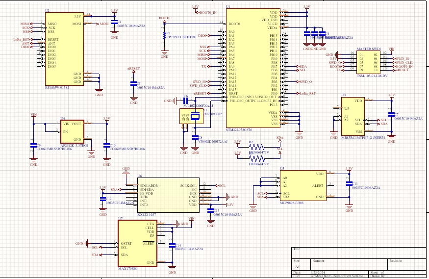

The circuit has a LoRa radio for sending signals to the gateway, a KX122-1037 accelerometer, a MCP9808 temperature sensor, a MAX17048 battery sensor and a MB85RC FRAM. I connected the TX pin to the arduino Mega to get a DEBUG display on the arduino IDE's serial monitor.

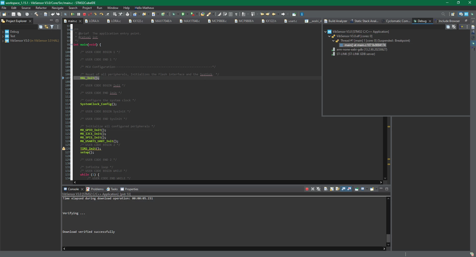

I assembled a PCB with the wiring diagram in the attached image, and it worked well for programming the microcontroller. However, I started to experience some problems when executing the code.

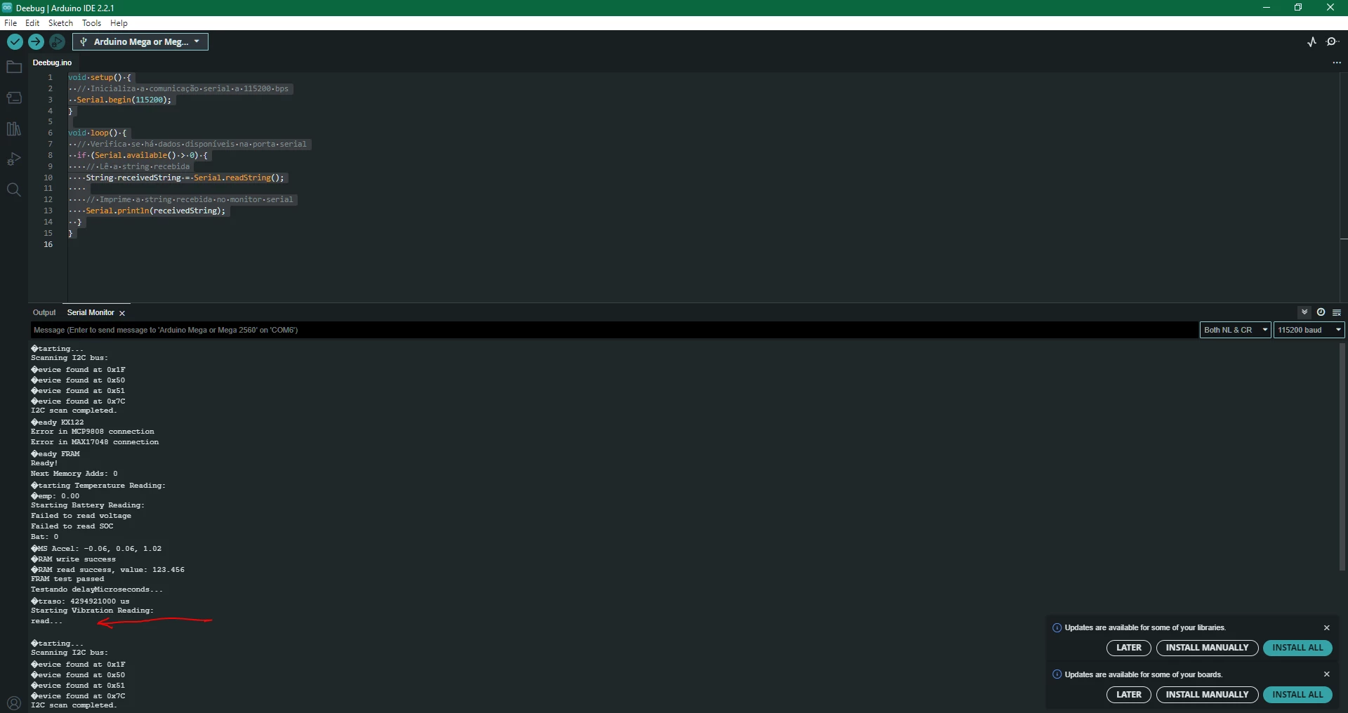

  • Firstly, my code is only executed by the chip when the system finishes uploading and resets it. I added an external 10K pull-up resistor to the chip's reset (which wasn't on the PCB). Now I can run the code whenever I pulse GND on the pin. However, it should run whenever the system is connected to power, which is not happening.
  • Secondly, my code is crashing in the accelerometer reading loop, basically I added a loop that reads the accelerometer 2048 times during one second, spacing the readings with a microsecond delay calculated in the setup method. The loop code runs well up to about 30 samples and then stops. I've tested the delay separately and apparently it works. And I've tested the loop with no other code in it, just the delay, and the same error happens.

I added the changes to the delay and ran the Debug.
In the STMCube debug mode, it is stuck on HAL_Init.
In Run mode, it runs up to the same delay point and doesn't go any further.
Andrew Neil
July 1, 2024
So step into that function to see where, exactly, it's getting stuck.

Why is your debug output corrupted at start of line? I saw this once when I was multiplexing a pin between SPI and UART modes, and was not respecting the timing for CS for the other chip when switching.
You should look into it - later.
"- If someone's post helped resolve your issue, please thank them by clicking ""Accept as Solution"".- Please post an update with details once you've solved your issue. Your experience may help others."
MatheusMarkies
July 1, 2024
Well, as I'm using the Mega which is powered by a 5V voltage, I believe it's corrupted by the difference in power supply voltages and the lack of a level shifter in the UART.

@MatheusMarkies , please carefully define what you mean by "Crashing". What are the observable symptoms? is the debugger inside the hard fault handler? does the chip simply become unresponsive? do flames shoot out of PD2, together with a strong smell of sulphur while one faintly hears the screams of the damned emanating from the depths of the cache unit's bowels ? what?
MatheusMarkies
July 1, 2024
By crash I mean that it stops sending signals via the UART debug, and only comes back if I restart it. By the last signal it sent I can tell where it stopped.
