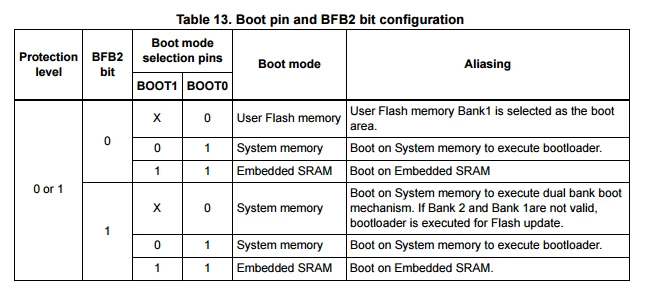

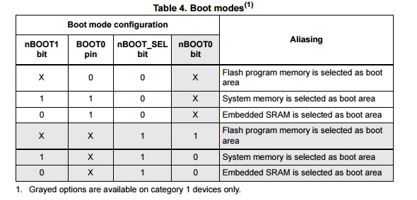

We are designing a new product around the STM32L081, in reading the reference manual :
http://www.st.com/content/ccc/resource/technical/document/reference_manual/21/bd/0f/bd/1c/88/40/f0/DM00108282.pdf/files/DM00108282.pdf/jcr:content/translations/en.DM00108282.pdf
We have two tables concerning the boot mode which are not giving the same mode for BOOT0 ; BOOT1 combination.
In the chapter 2.4 Boot Configuration,
And in the chapter 3.3.2 Dual-bank boot capability,
We have the following table discribing the different Boot Mode in Dual Bank
The two tables are telling opposite information concerning the boot mode regarding the value of BOOT0 and BOOT1, for Embedded RAM and System Memory booting.
Which table has the corrects values or did I miss something ?
Thanks,
Sylvain

    Hi
    LEVENE.Sylvain
    I confirm that there an issue on the tale
    Your feedbackhas been reported internally to update the related reference manual in coming release.
    Thank you for highlighting the issue and sorry for any inconvenience it may bring.
    -Nesrine-

    Dec 8, 2016 11:24 AM UTC
    Posted on December 08, 2016 at 11:24
    Hi
    ELMHIRI.Syrine
    Thanks for the feedback, we will only take into account the content of chapter 2.4 boot configuration.
    Sylvain
