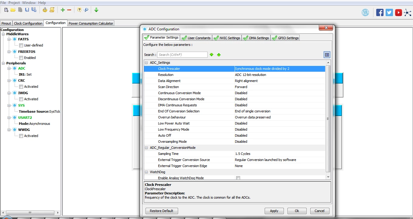

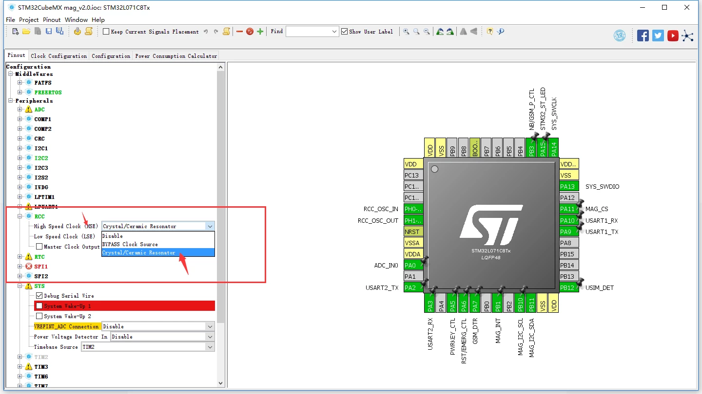

    I'm using the same chip, and I have the same issue but I have get it work. You need to choose the HSE first in RCC like the pic below,and then you can change PLL using HSE. ADC's clock you can change with the code:
    hadc.Init.ClockPrescaler = ADC_CLOCK_SYNC_PCLK_DIV1;
    #define ADC_CLOCK_SYNC_PCLK_DIV1         ((uint32_t)ADC_CFGR2_CKMODE)    /*!< Synchronous clock mode divided by 1
                                                                                   This configuration must be enabled only if PCLK has a 50%
                                                                                   duty clock cycle (APB prescaler configured inside the RCC must be bypassed and the system clock
                                                                                   must by 50% duty cycle)*/
    #define ADC_CLOCK_SYNC_PCLK_DIV2         ((uint32_t)ADC_CFGR2_CKMODE_0)  /*!< Synchronous clock mode divided by 2 */
    #define ADC_CLOCK_SYNC_PCLK_DIV4         ((uint32_t)ADC_CFGR2_CKMODE_1)  /*!< Synchronous clock mode divided by 4 */0690X00000609M2QAI.png

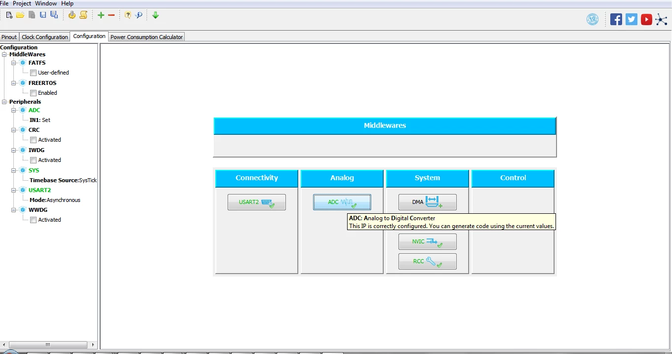

    As shown below click on Configuration >> ADC
    You will get adc configuration Options,
    ADC Setting >> Clock Prescaler can be found.
