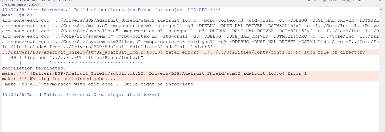

STM32L LCD character print error
When trying to print characters on the onboard lcd screen of STM32L152RC dev board, getting this error. what to do?Screenshot 2023-10-23 170315.png

Find the file in your CubeL1 repository and put it in your project tree structure so it can be found. Or fix the path.
