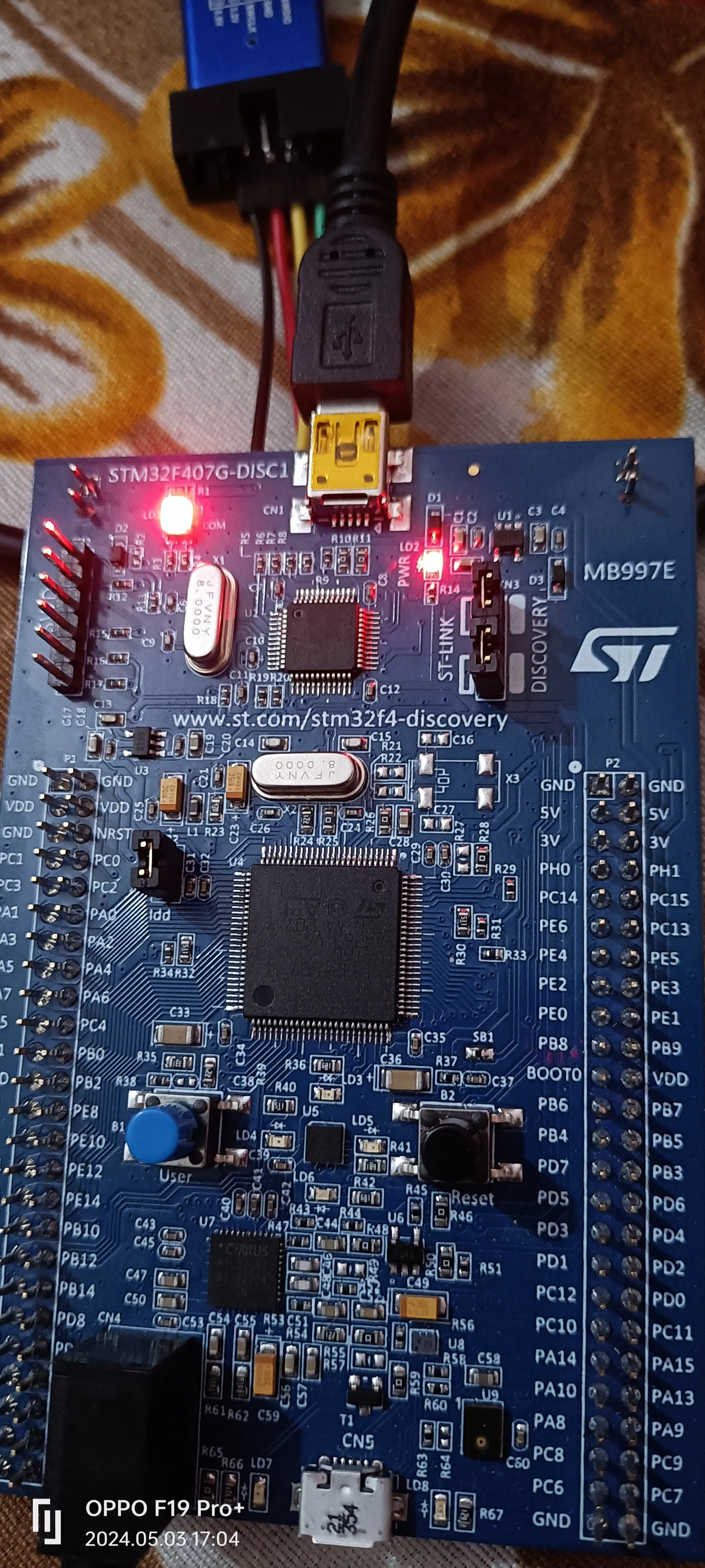

    May 3, 2024 11:37 AM UTC
    In my board  LD1 only RED colour LED is blinking. Is is hardware faulty or some other issue .

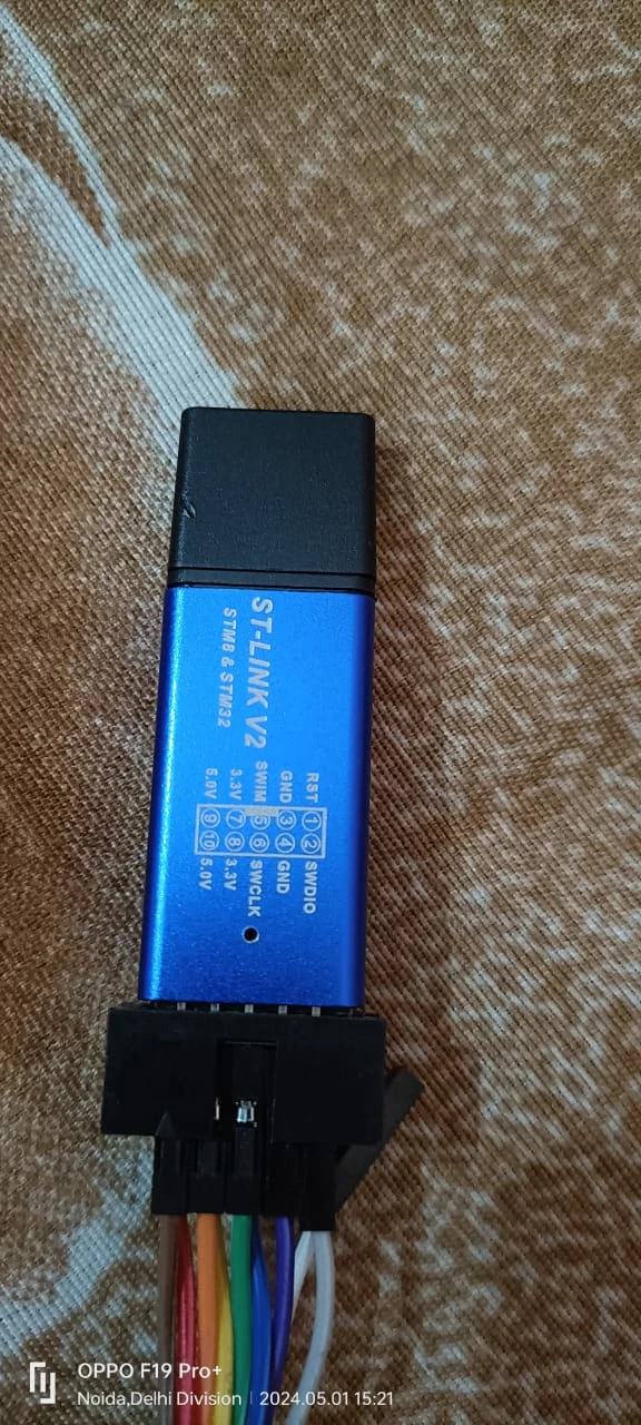

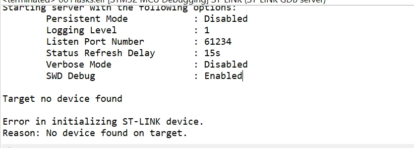

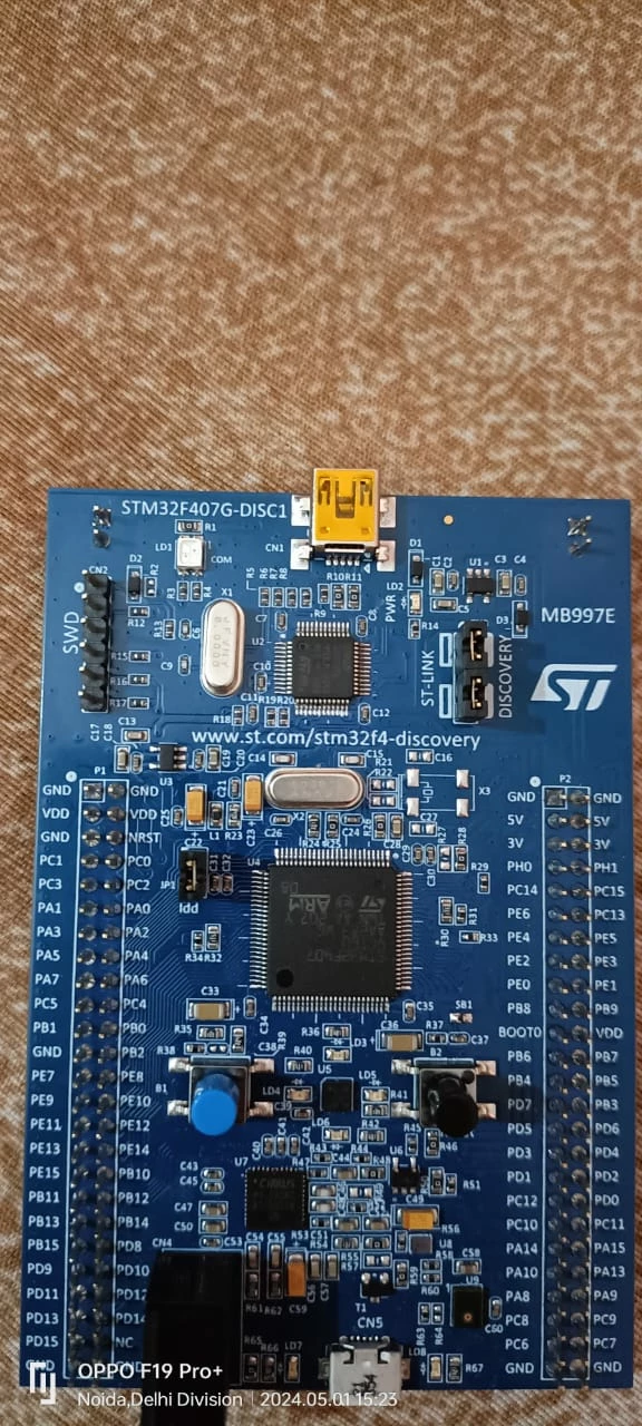

    Kindly provide pinout diagram b/w ST-LINK V2 and STM32F407G-DISC1 also share , solution for Debugging issue Capture2.PNGWhatsApp Image 2024-05-01 at 3.24.53 PM.jpegWhatsApp Image 2024-05-01 at 3.24.52 PM.jpeg
