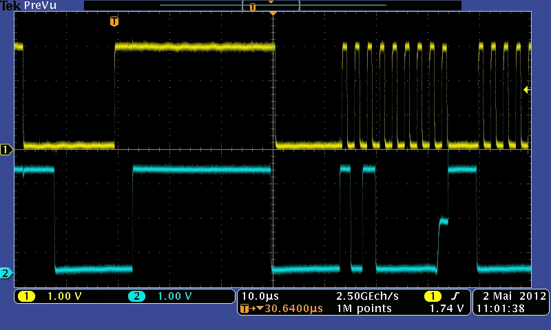

    olivier239955_stm1_stmicro_com
    May 3, 2012
    Posted on May 03, 2012 at 15:30
    I share a screen of a result of my code in my oscilloscope.
    Ther is an strange thing between my start and a adress send, i don't know why i have this attent time, and an other strange thing, it's my ACK it's not 0 but not 1 it's between the both. I've testes for twot EEPROME ( the m24lr64 and m64c64) the result are the same.
    Anyone can help me, or have this same problem.

    Posted on May 04, 2012 at 14:20
    try configuring the pins in open drain mode
    May 4, 2012
    Posted on May 04, 2012 at 15:22
    thank you ver much that was the mistake in my code.
