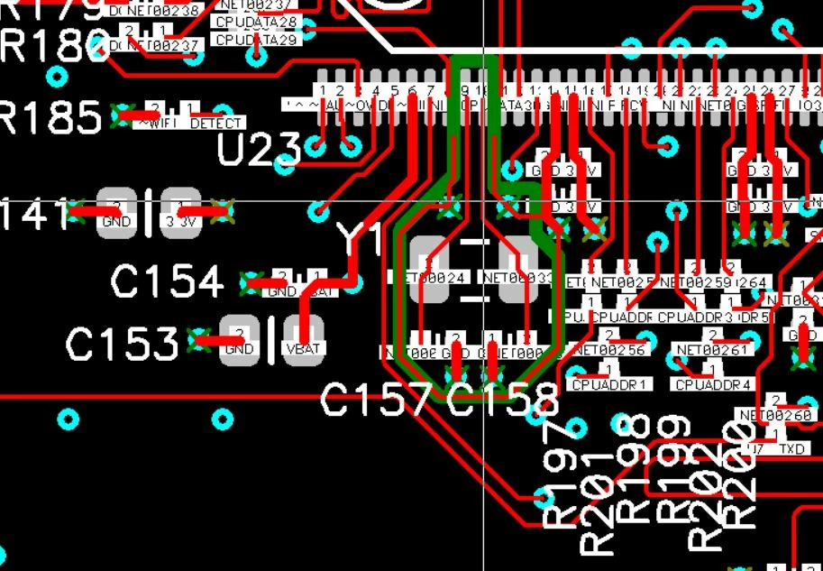

I've followed the ST guidelines for crystal layout including guard traces around the crystal tied to ground. It is a 6 layer board with ground right below the top layer. Picture attached. This RTC just does not work consistently from CPU to CPU.

It appears you have a ground layer. How does it look like? Is it uninterrupted between the vias from C157/C158 and the GND pin closest to the xtal pins? (note the common via in franck23 ' s post - a nice way to reduce unwanted parasitics, although not critical).
What is the power supply arrangement? What is the power supply voltage? Is VDD/VSS as measured at the closest pins to the crystal pins rock stable?
How is VBAT connected exactly?

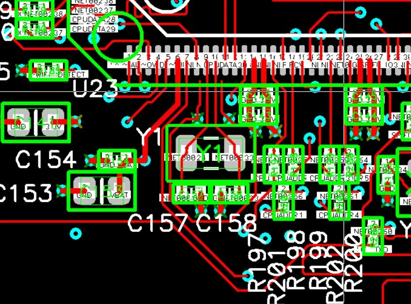

The ground plane is cut out under the crystal per the ST app notes, though that did not seem to help anything (was a solid ground plane in earlier versions). Ground layer turned on in the attachment so you can see what I mean. Power supply is 3.3V and looks clean to me. I have a 2.2uF and a 0.01 uF cap on VBATT by the CPU. VBATT comes from a 2032 battery through a diode and 1K resistor. This is really a moot point at this time, I've already added an external RTC to get a reliable clock. I do appreciate the feedback, though.

Those unconnected guard track ends are not ideal but I don't see a problem with them and they may be a good thing. A solid 0V plane under the crystal and the 0V the first inner layer below it should have been okay comparing with what Franck has done. But just an aperture in the power planes beneath the crystal's own plane is often recommended, but I do not think you need to do that. The significant thing is that I do not see an 0V connection to the crystal.
That does not give you anything clearer.

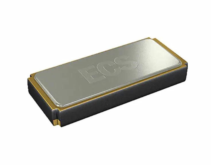

FWIW, my initial tests on one board did not reveal any problems with STM32H753ZI, medium-high drive, either ECS-.327-7-12R-TR or CM8V-T1A-32.768KHZ-7PF-20PPM-TA-QC, and 4.7 pF caps.
