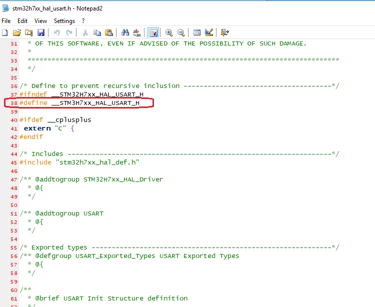

There is a "2" missing in the define at the beginning of the stm32h7xx_hal_usart.h file. Can somebody fix it for the next release? - if there is one.
/* Define to prevent recursive inclusion -------------------------------------*/
#ifndef __STM32H7xx_HAL_USART_H
#define __STM3H7xx_HAL_USART_H
#ifdef __cplusplus
 extern "C" {
#endif

Hello @Tomasz Zeman​ ,
Thank you for bringing this to our attention.
This issue will be fixed in the next release of STM32CubeH7.
