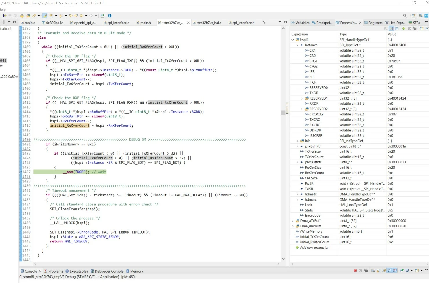

In troubleshooting my issue, right at the bottom of the loop, I added an "if" statement checking to see if for any reason initial_TxXferCount or initial_RxXferCount go below zero (though they are defined as uint16_t) OR if for any reason any of them go above "32" or EOT is reached. Sure enough it hit my breakpoint. Then, I noticed that at that point TxXferCount = 0x6 and RxXferCount =0xD. Yet, EOT was set and both TXP and RXP show they are cleared. Is that expected? BTW, at that break point, the SR flag is showing that both UDR and OVR are set! I am not sure if that's because of the break point with Transmitter hardware still continuing while on break point that caused the UDR/OVR to be set or if something actually went wrong to cause those flags to be set at EOT.
Note: Attached file (STM32H743 - Breakpoint on EOT during 32 bytes SPI transfer using HAL_SPI_TransmitReceive routine.jpg) shows my added "if" statement for the breakpoint along with the state of hspi4. Please note that the if statement check for iWriteMemory is there so that it would only do the break point if I am doing the HAL_SPI_TransmitReceive during a 32 (0x20) bytes transfer and not during shorter transfer calls.
With this, I hope someone can shed some light into the issue.

At lines 1432 -1442 this routine checks timeout and should return with status HAL_TIMEOUT if the transfer has not ended. Since this does not happen, something else is broken (systick interrupt is blocked?)
SPI controller of STM32H7 is more complicated than in other models. Show the initialization of SPI.

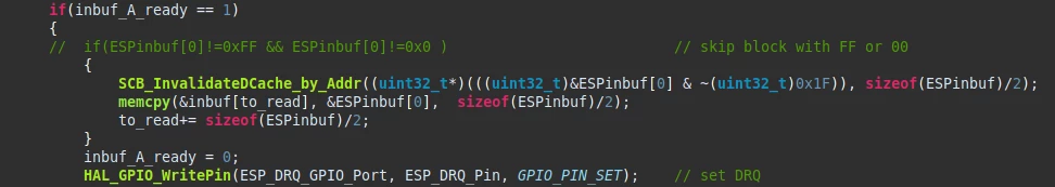

just because i have also an H743 here: i am running up to 4 SPI , one is in slave mode receiving 2KB blocks at 12 Mbit. no problems, so i think your problem is not about the spi , but something else.
first comes to my mind: problem at 32 byte -> the cache lines are 32 B.
try : switch off d-cache, makes something better ?

ok - but there is not much to see, because i use HAL;
setting of spi->8bit, slave, ...is done in Cube -> gen.code. (i need not to show - right? )
MPU is not used (i dont know how, cache is managed by direct instructions)
then in main:
(MX.. init , by HAL )

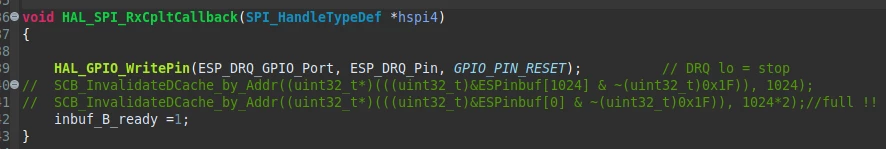

0693W00000aICNCQA4.png0693W00000aICNHQA4.png0693W00000aICNRQA4.pngnow it is running, always ...when data from spi comes, then copy from input buffer (in callback just set flag: buffer ready):
0693W00000aICNgQAO.pngcache "clear" was not effective here, so i put it only just before using the buffer ->
then copy it, when needed (and clear flag :(
0693W00000aICNlQAO.pngdata from ESP is 8bit , at 12 Mbaud speed; no dropouts or errors (at used speed);
why using HAL ? just because overall speed is not high, a 2KB data block needs minimum 2ms , so "slow HAL" calls add some 2us or so...not intersting, to bother around with the registers... :) ; would not make anything faster or better, because the data rate is coming from the source and has big interval breaks up to 500ms ;
