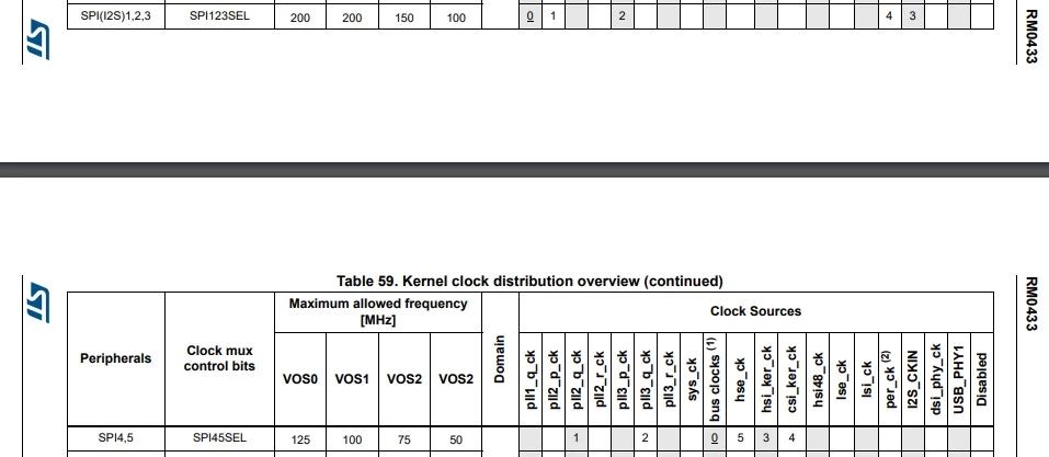

STM32H7x3 max SPI123 and SPI45 kernel clock freq?
I can't seem to find it in the datasheet: what is the max allowed kernel clock frequency for SPI123 and SPI45?

https://www.st.com/resource/en/reference_manual/dm00314099-stm32h742-stm32h743-753-and-stm32h750-value-line-advanced-arm-based-32-bit-mcus-stmicroelectronics.pdf

Usually the Kernel Clock Distribution Overview in the RM not the DM/DS
On the H745/H747 to hand SPI123 200MHz SPI45 125 MHz

Thank you! I went crazy looking for that. Now I see it, in table 59 of the RM, rev 7. Thanks
