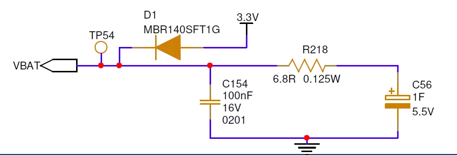

One more query related to VBAT. Please refer below capture and provide your feedback for VBAT. Diode D1 and other components are, ok?

-> One more query related to VBAT. Please refer below capture and provide your feedback for VBAT. Diode D1 and other components are, ok?
Please don't ask many questions in the same thread. I recommend you to create a new post related to VBAT.
