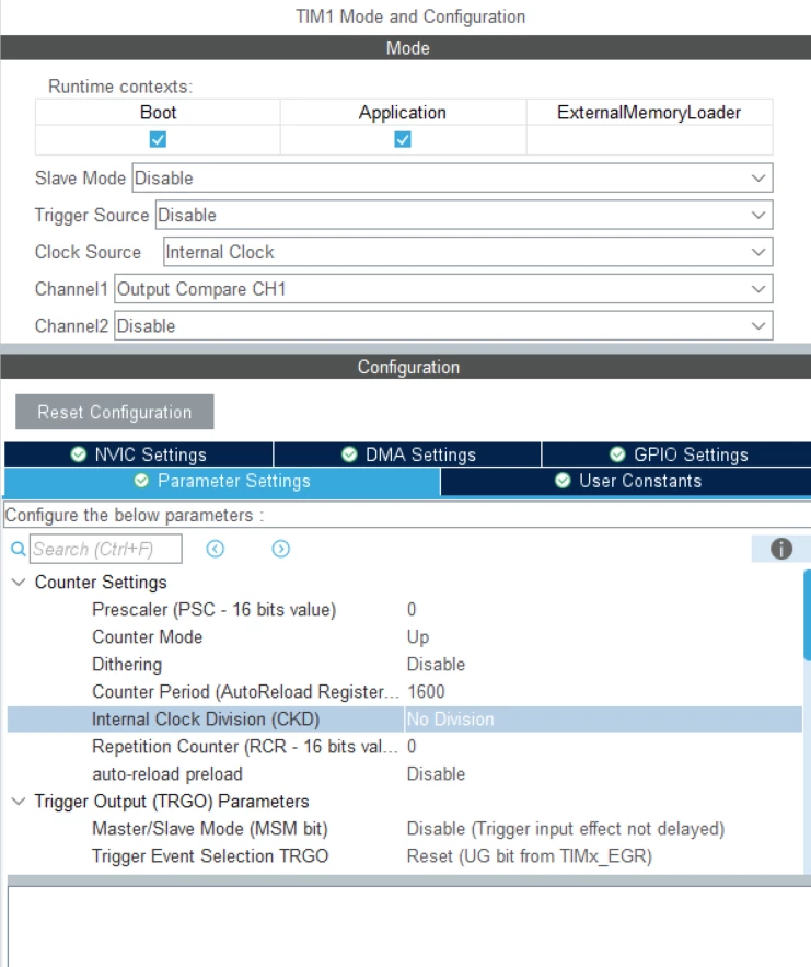

I am testing Tim1 output compare by toggling PA8 on the micro... - the timer settings are
period = 1600, no clock divisor or prescaler and my clock config is below

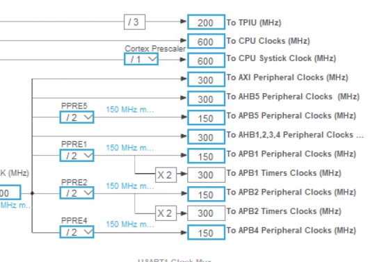

So even if I assume a counter clock of 150Mhz (APB1, APB2 peripheral clocks) and the formula of clock/2*(period+1) as the frequency I should see it toggle at 21.34 us?

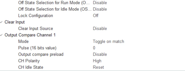

So I have TIM1 configured with a period of 1600 and it is setup to toggle PA8 as the output (via the OUTPUT_COMPARE_CH1) setting - see below
I think you might be right though - maybe it's just latencies - I will try increasing the period and test as you suggested - thanks for all the suggestions
Oh the settings for the output toggle are as below
That is the clock to the timer's APB bus interface.  The timers themselves clock at 2x that rate (i.e. 300 MHz), as shown in the clocking diagram you posted.  I don't know the STM32H7S3V8T6 specifically, but presuming TIM1 is on the APB1/2 bus like other STM32 families.
That doesn't fix your measured vs calculated discrepancy, but makes the calculated period 10.67us.
