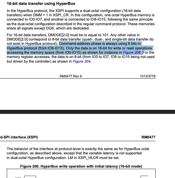

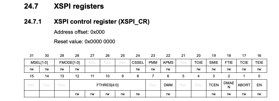

Bit 6 DMM: Dual-memory configuration This bit activates the dual-memory configuration, where two external devices are used simultaneously to double the throughput and the capacity. 0: Dual-memory configuration disabled 1: Dual-memory configuration enabled Note: This bit can be modified only when BUSY = 0.
https://www.st.com/resource/en/reference_manual/rm0477-stm32h7rx7sx-armbased-32bit-mcus-stmicroelectronics.pdf
Thank you for the document. After reading it carefully, I now understand the byte order (B1 B1 B2 B2) correctly.
However, I still have a problem with chip register configuration in dual-memory mode.
What I'm trying to do: Configure CR0 register (address 0x1000U) of W956D8MBYA in XSPI dual-memory (DMM=1) mode.
What I observe: After writing CR0 and reading it back, I always get a value corresponding to IR0 — regardless of which address I use (0x0000, 0x0002, 0x1000, 0x0800, etc.).
What I found in RM0477:
"Command-address phase is always using 8 bits in HyperBus protocol (from IO0-IO7). Only the data is on 16-bit for write or read operations accessing the memory space (from IO0-IO15)."
"For memory register accesses, the data is on 8-bit (from IO0 to IO7, IO8 to IO15 being not used but driven by the controller)."
This suggests that in 16-bit dual-memory HyperBus mode, register space access only works through IO0-IO7 (Chip1), and Chip2 (IO8-IO15) is completely ignored during register access.
Question: Is it possible to configure CR0 registers of both chips in dual-memory mode? If so, how? Do I need to temporarily switch to single 8-bit mode with separate CS# for each chip to initialize the registers?
